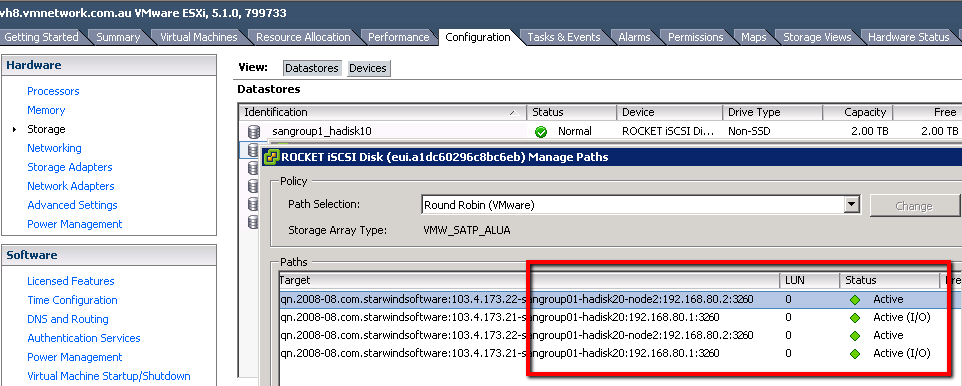

Still testing Starwind v6. Has anyone else noticed that ESXi 5.1 build 799733, doesnt interpret the ALUA preferencing correctly when using round robin with multipaths ? Our older hosts running ESX 5.0 or ESX 4.1 appear to work fine. I took a couple of screenshots to illustrate.
This is build 799733, and these are not the correct preference paths, it should be node 2. this hypervisor always defaults to node 1.

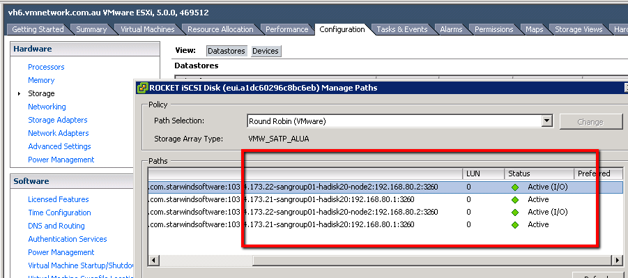

ESX 5.0 when seeing the same paths gets it correct.
I lodged a support ticket with vmware. Anyone know if there is a fix, or if I have missed something obvious.

Hey anton, yes we have two nodes running 4 HA disks on our storage network running v6 Build 20120927. first two HA disks have alua preference to node 1, second two disks are preferenced to node 2. esxi 5 and under recognises the correct round robin pathing but I have tried multiple esxi 5.1 hosts, and they always prefer node 1. I figure it must be a vmware bug, but it definetly doesnt work with vmware 5.1. I have lodged a support ticket with vmware.

ESXi 5.1 Host, NOT Correctly Preferencing Path to Node 2:
eui.a1dc60296c8bc6eb
Device Display Name: ROCKET iSCSI Disk (eui.a1dc60296c8bc6eb)
Storage Array Type: VMW_SATP_ALUA
Storage Array Type Device Config: {implicit_support=on;explicit_support=off; explicit_allow=on;alua_followover=on;{TPG_id=1,TPG_state=ANO}{TPG_id=2,TPG_state=AO}}
Path Selection Policy: VMW_PSP_RR
Path Selection Policy Device Config: {policy=rr,iops=1000,bytes=10485760,useANO=0;lastPathIndex=2: NumIOsPending=0,numBytesPending=0}
Path Selection Policy Device Custom Config:
Working Paths: vmhba4:C0:T6:L0, vmhba3:C0:T6:L0
Is Local SAS Device: false
Is Boot USB Device: false
ESXi 5.0 Host, Correctly Preferencing Path to Node 2:
Storage Array Type Device Config: {implicit_support=on;explicit_support=off; explicit_allow=on;alua_followover=on;{TPG_id=2,TPG_state=AO}{TPG_id=1,TPG_state=ANO}}
Path Selection Policy Device Config: {policy=rr,iops=1000,bytes=10485760,useANO=0;lastPathIndex=0: NumIOsPending=4,numBytesPending=20480}
Working Paths: vmhba4:C0:T12:L0, vmhba3:C0:T13:L0
