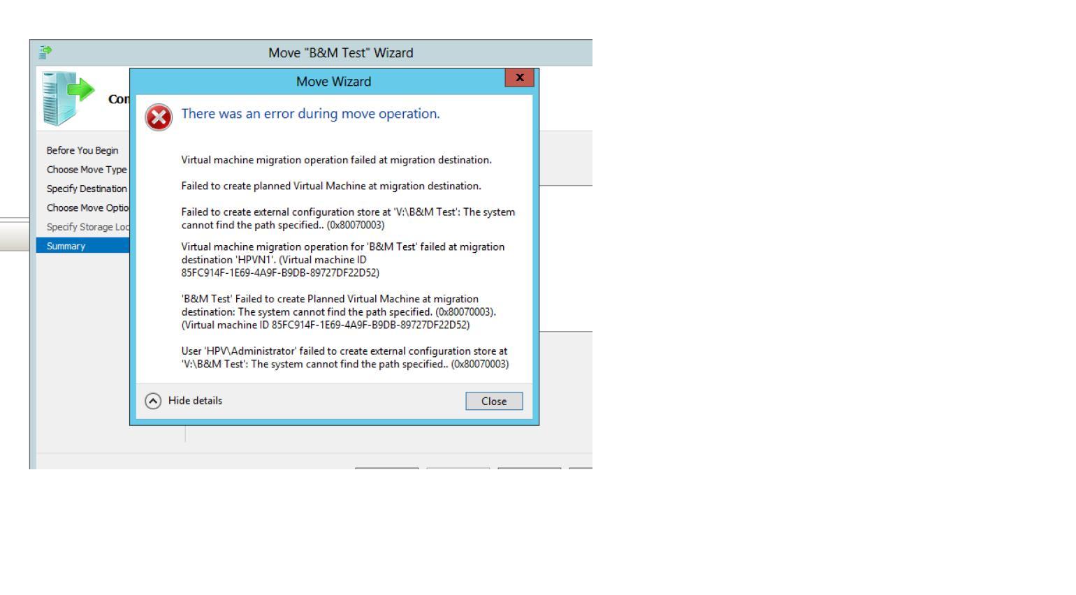

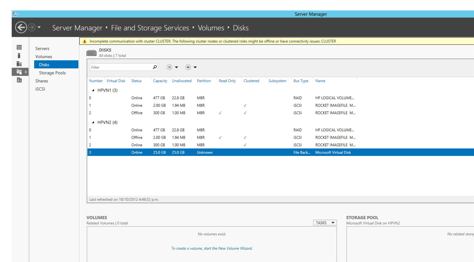

Ok,
Tried a live migration and it seems I have something wrong.
The first page of the attched images came up on the source machine...
The second is the error on the destination machine.
The only error I seem to have when I validate the cluster is a DNS issue of some kind, is this related to the error I am getting when trying to live migrate?

WarrenW
Posts: 11
Joined: Mon Oct 08, 2012 10:33 pm
Tue Oct 23, 2012 1:58 am
Hi All,
We are making progress. Appears there are some DCOM services that are blocked by the windows firewall by default. Enabled the predefined rule and whilst I still cannot do a move between hosts (I think this is my error of understanding how this works), I can have a 2003 server running as a vm and whilst connected via a RDP seesion, turn off the machine that is running the vm and it transferred over to the second node and reconnected the RDP session from my client machine and lost no data (apparently) within 5 retries of reconnection from the client.
So I have an HA cluster working. All I have to do now is to learn how to use it properly, break it a few times and restore the VM's etc before going into production.
This is good news.
I am impressed with the speed.
With a bit more testing and understanding (this is my first Hyper-V cluster) I can be confident we will be purchasing the software.
Thanks heaps for the help.
Have a beer on me!
Cheers
Warren.
