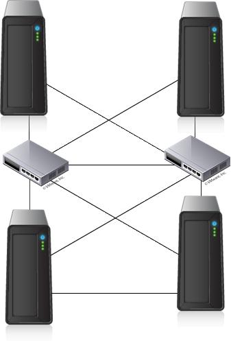

Perhaps a very specific use case:
- we plan on deploying an HA Starwind iSCSI cluster with two nodes. The primary porpose will be to serve up high performance, low latency storage to a number of SQL servers.
- each node will have a couple FusionIO flash PCIe cards. Two 10GbE NIC ports per node for general iSCSI traffic + heartbeat, two 10Gbe ports for sync. This would be a total of 4 iSCSI ports in the cluster to support storage traffic to servers.
- all volumes/LUNs will be HA
- All client servers (ie. SQL servers) will have two 10GbE ports
- for redundancy, each server is connected to 2 active, stacked switches
How would you configure this scenario at the host and client end to maximize performance and redundnacy?
Thanks.
Thu Oct 25, 2012 3:53 pm
I`d recommend to configure the system as follows.
As you can see this config requires to have 1 additional NIC on each SANserver but it is required in order to maximize performance and redundancy. I`d suggest you to have one more NIC that`ll serve for non-iSCSI traffic on the client machine as well.
