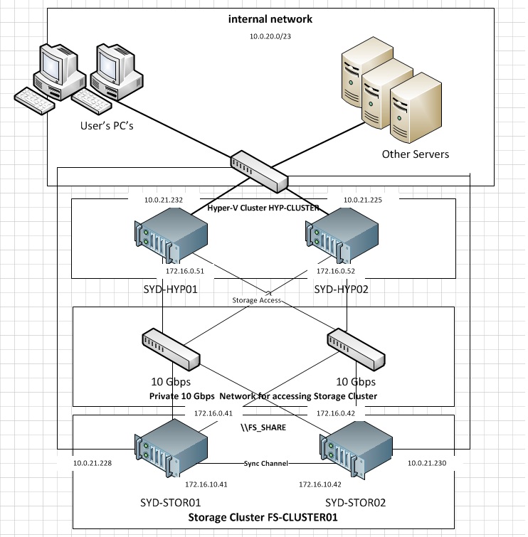

Hi, i've deployed test Hyper-V cluster over SMB share. Everything works fine, but i couldn't explain poor performance when i'm copying large file to network share. The speed is so slow (aprox 80 Mb/s)
Picture of current config
config
config
four intel platforms are the same type, 2 for hyper-v cluster, 2 for storage cluster
each Hyper-v node has 192 Gb of RAM, 2 CPU's (6 Cores), RAID 1 HDD 7200 (for OS)
each Storage node has 16 Gb of RAM, 1 CPU's (4 Cores), RAID 1 SSD's (for OS) (build in controller) and RAID 6 (8 SSD's) Intel hardware controller PSBL080 for storage
for storage network we use 10 Gbps switches.
OS on all servers is Windows 2012.

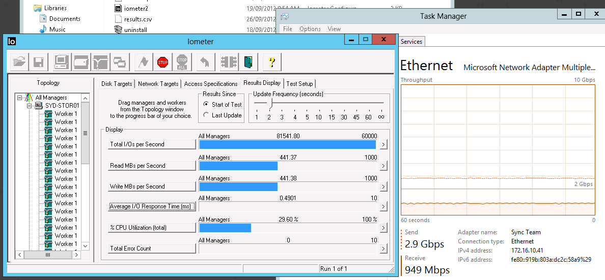

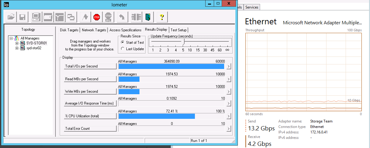

for network tests i used iometer, network speed is excellent, i could load storage network up to 20 Gbps (we use NIC teaming for each connection)
Sync network - 3 x 1Gbps in team - by using iometer i can load it up to 2,9 Gbps.
it seems network is not an issue.

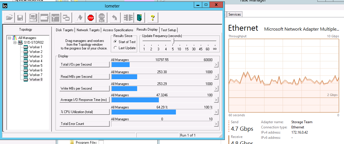

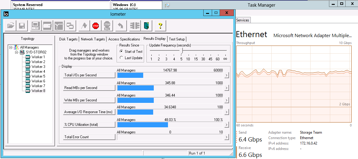

I used iometer to load network
Test config intel fileserver pattern, 20 Workers total
Some screenshots
First Storage Network load
Second Sync Network load
It seems network is ok, high speed with low level of average latency.

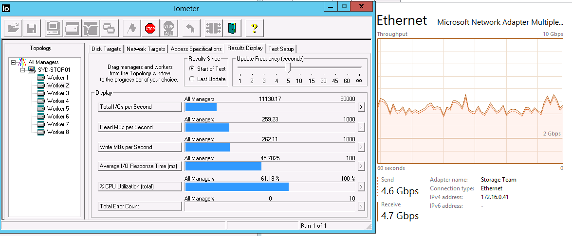

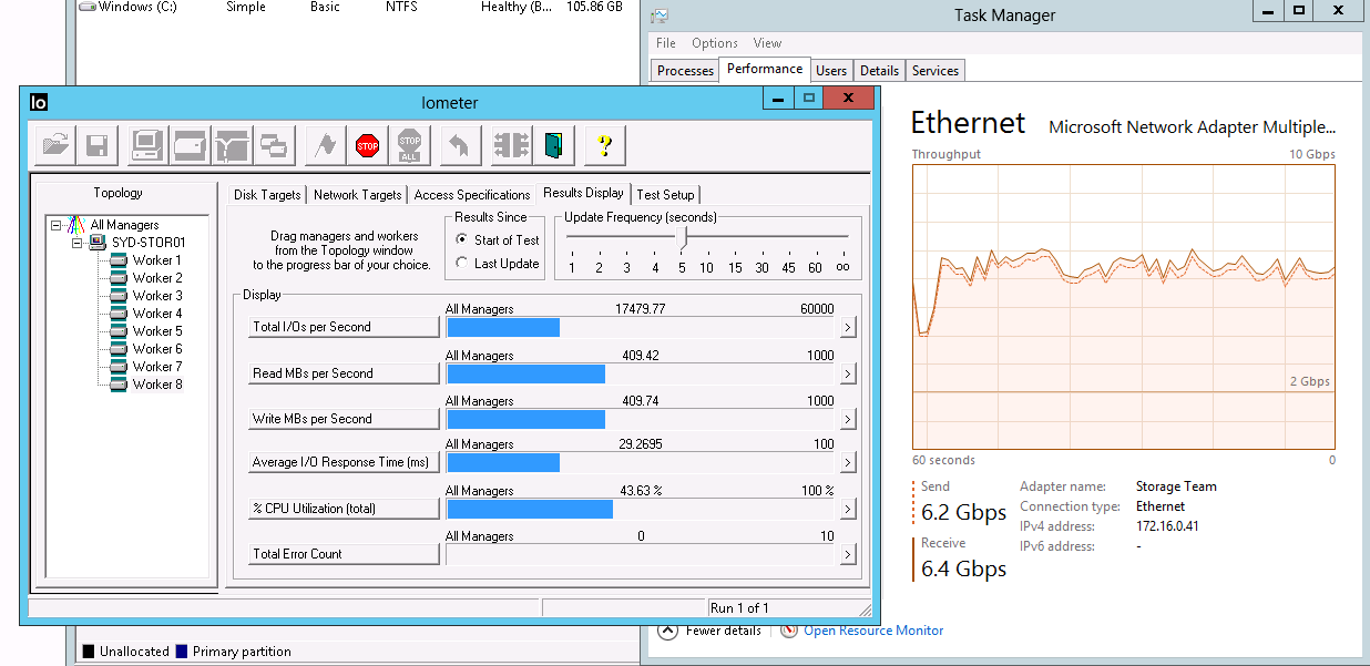

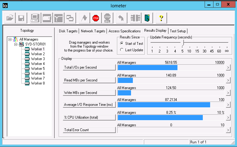

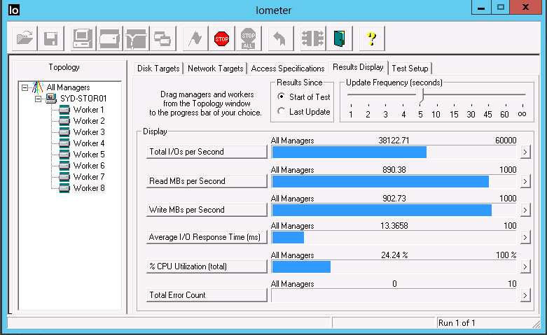

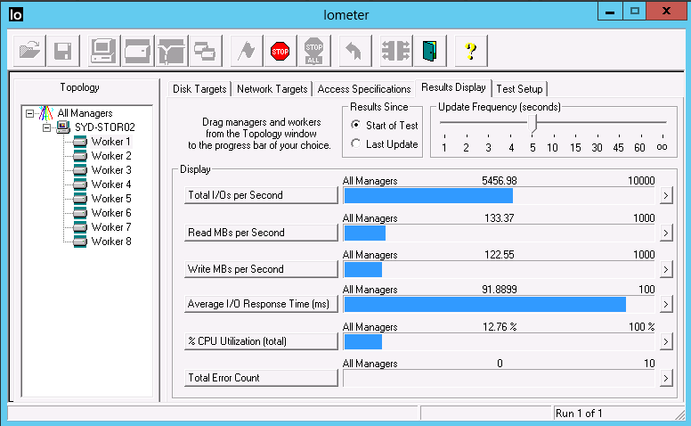

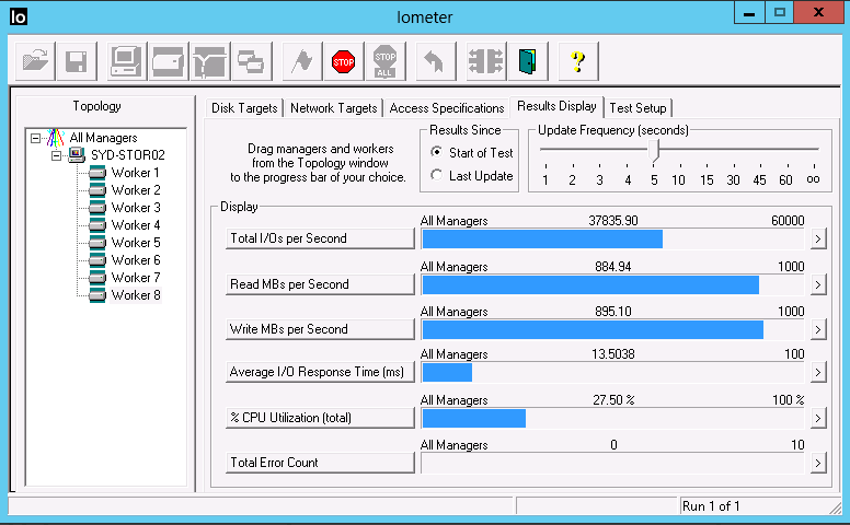

TESTING LOCAL STORAGE (drive C and drive D separately, I would like to see any difference between built-in RAID 1 and H/W RAID 6)
Test config
• 32K 100% read sequential, # of Outstanding IOPS= 64
• 32K 100% write sequential, # of Outstanding IOPS= 64
• 32K 100% read random, # of Outstanding IOPS= 64
• 32K 100% write random, # of Outstanding IOPS=64
• 64K 100% read sequential, # of Outstanding IOPS= 64
• 64K 100% write sequential, # of Outstanding IOPS= 64
• 64K 100% read random, # of Outstanding IOPS= 64
• 64K 100% write random, # of Outstanding IOPS= 64
STORAGE NODE 01
DRIVE C:
genko2012
Posts: 12
Joined: Tue Sep 18, 2012 1:31 am
Wed Sep 26, 2012 3:48 am
sorry it seems i cannot add more than 3 pics in one post
STORAGE NODE 02
DRIVE C:
STORAGE NODE 01
DRIVE D:
STORAGE NODE 02
DRIVE D:

Wed Sep 26, 2012 9:20 am
As we can see from the tests (screenshots below) the Average response time of your Disk System is >90ms, so I think this is the first thing that is need to be fixed because the latency is really important, it should be not more than 10ms (actually <5ms is required).
