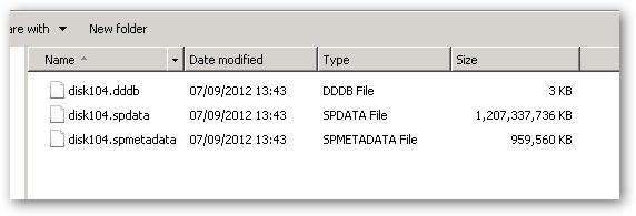

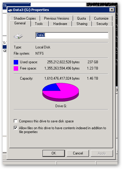

Err, I've think I've done something wrong here. I've created a 1.5TB deduplicated disk (DDDiskEx1) and attached it to a target. I've then added that target to our main file server as the G: drive. I left robocopy running yesterday and so far it's copied 237GB (see sshot-1png). When I look at the size of the spdata file, I expected it to be somewhat smaller (due to some deuplication) but it's not - it's 1.12TB!! See sshot-2.png.

Rob, what deduplication block size do you use? Did you enable data delete thing? Did you just copy the files or it was overwrite process?

I see... Please use 4KB deduplication block and enable "re-claim used space" (delete) option and try again. I'll ask engineers to re-check big dedupe blocks for efficiency. Thanks!

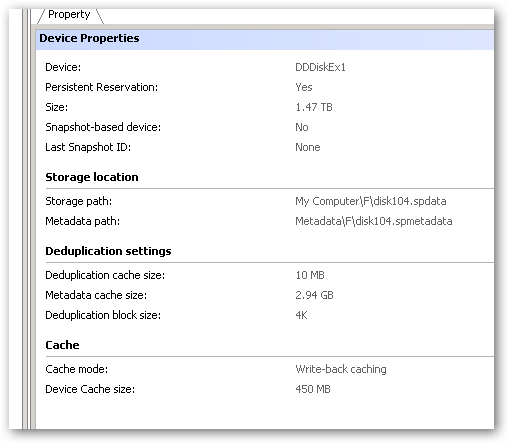

One other change request for you to raise. You cannot tell from the device properties window whether deletion is on or off. See attached screenshot. Needs "Deletion On/Off" adding under deduplication settings.

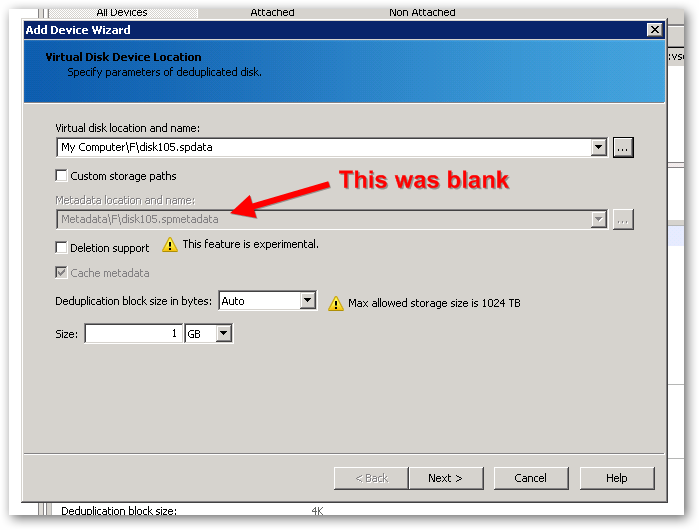

Whilst I'm on the subject of little quirks, the first time I went through creating this deduplication disk and got to the bit where I specified the virtual disk location, the metadata location & name was blank. I'm afraid I didn't screenshot it at the time so all I can supply it when it worked the second time. I remember been very confused the first time as I wasn't sure what metadata was (I can guess), where to put it or what to call it.
Agree. I think we will add this when deletion support will stop being experimental.
Maybe this only happens on a new server build?
Maybe, but we couldn`t recreate this in our tests lab. If you will catch this once again it would be great if we could saw the screenshots and dtailed description of waht was done to get this. But I hope that we will never hear about this again :D

Deleted old disk and created a new one with 4k block size, not auto. So far it's looking better. 232GB of disk space used by Windows but the spdata file is 199GB. So a deduplication ration of 1.16. Will let it finished the entire copy of 886GB source data now.
