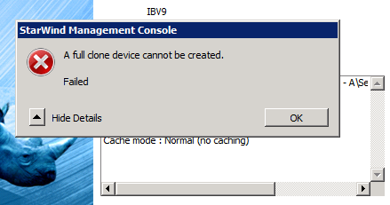

But when I tryed mounting the CDP, or creating a clone from a previous snapshot it fails
"A full clone device cannot be created." Details "Failed", I tryed several different snapshots

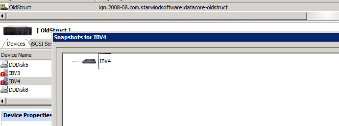

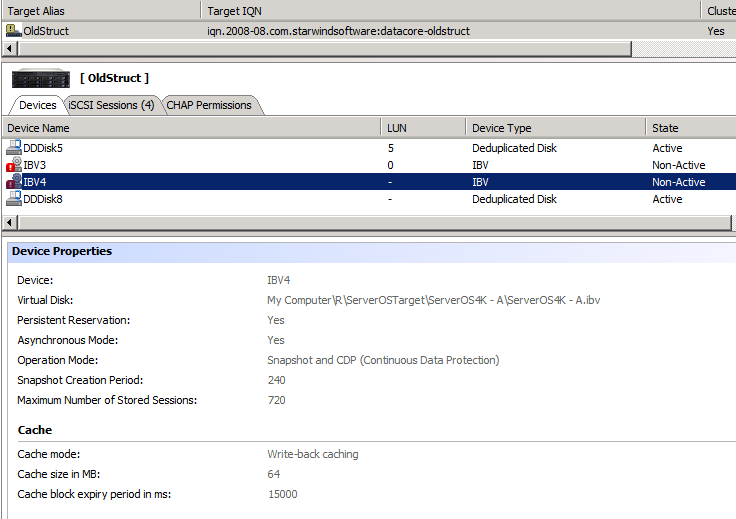

Failed CDP Device
Failed CDP Device
CDP pic.PNG (33.94 KiB) Viewed 27143 times
Non-Active CDP Devices
Nothing listed in Snapshot manger for the non-active CDP
Snapshot manager.PNG (16.02 KiB) Viewed 27145 times
Nothing in the snapshot manager

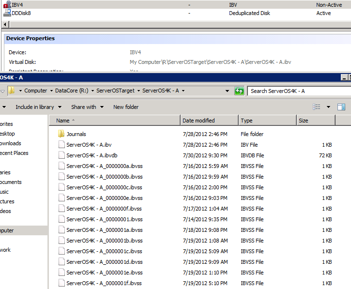

File Path of CDP
File Path of CDP

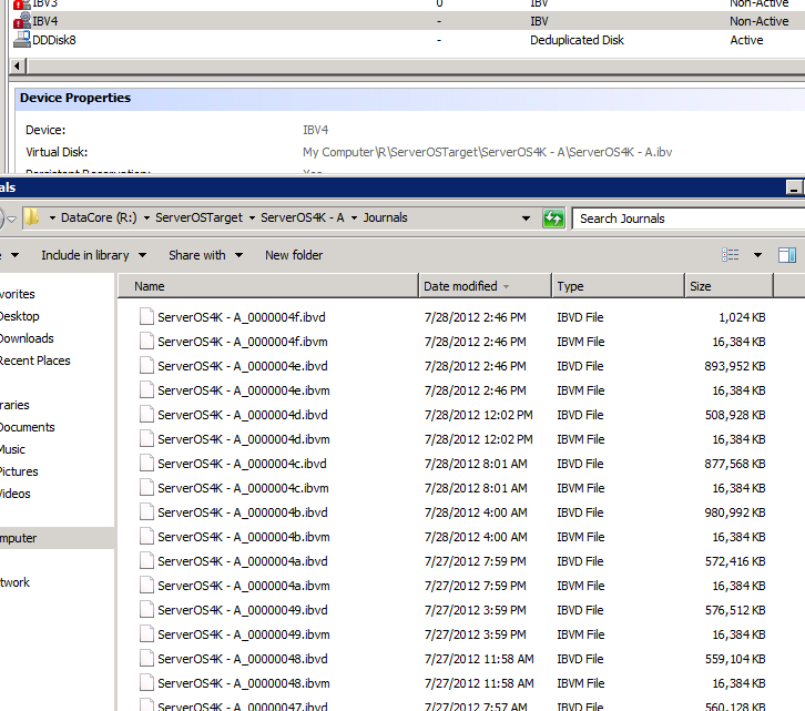

Journal files of IBV4
CDP Journals.PNG (58.17 KiB) Viewed 27137 times

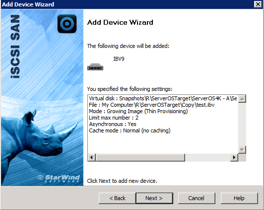

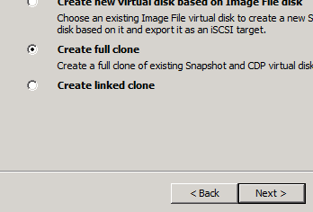

Create a Full clone of IBV4
Create a Full Clone.PNG (8.3 KiB) Viewed 27140 times

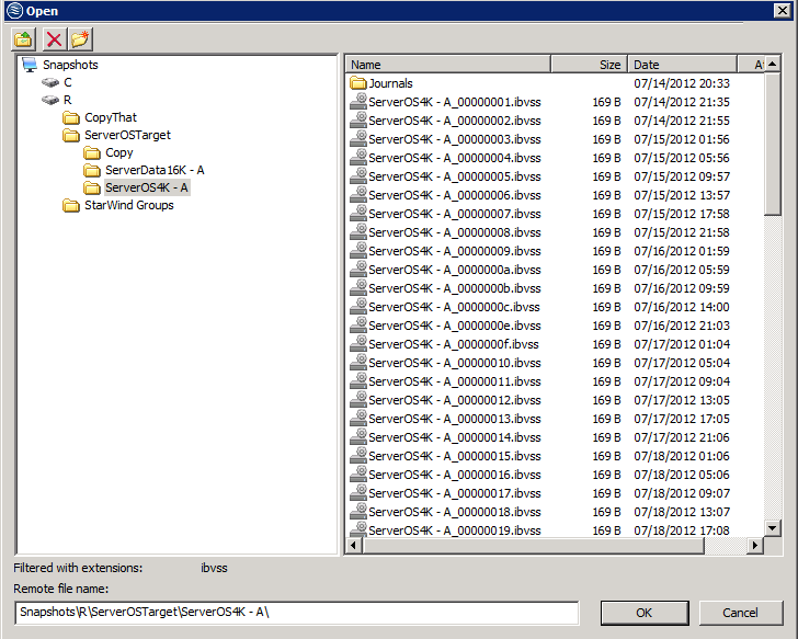

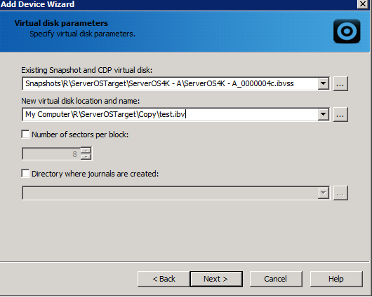

Snapshot List of IBV4 doen't matter what is selected here they all give same error
Snapshot List.PNG (59.68 KiB) Viewed 27144 times
Full Clone Save Location, and the 2nd to last snapshot selected
full clone save location.PNG (25.13 KiB) Viewed 27141 times

Final Add Device Wizard before error
Add Device.PNG (90.42 KiB) Viewed 27143 times
Error - Just a Simple - it Failed
