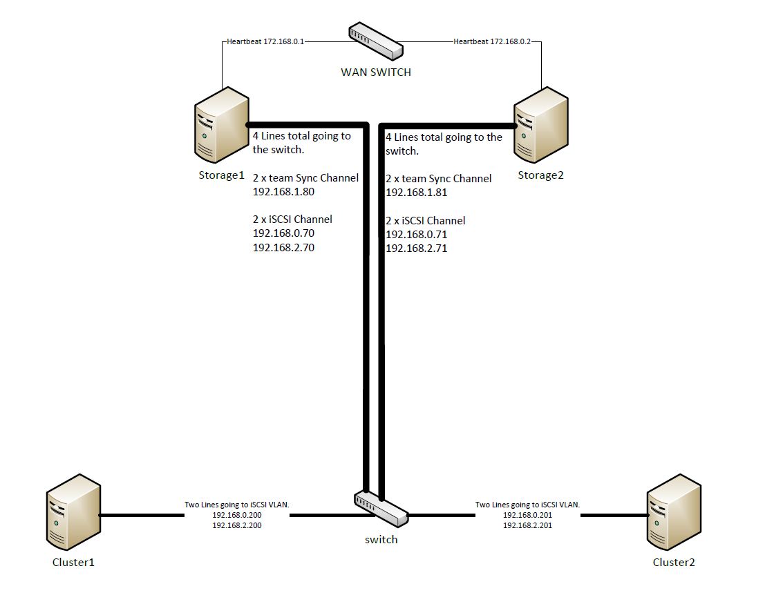

OK, could you please provide us with the detailed network diagram (visio perhaps) with all the IPs and bandwidthes described?
oxyi
Posts: 67
Thu Feb 23, 2012 5:51 pm
Here it is. Everything is 1Gb line.

Actually we strongly recommend to keep your synchronization channel data link separated from all other networks to avoid it to was overflooded with broadcasts, etc. That could be the reason.
I would also tried to exclude switch since it can lag too.

Sync channel data link is in its own VLAN as well. There could be a small possibility that there is some kind of lag within the switch, but I think it is highly unlikely.
If there was a lag somewhere, I would've experienced that with either CSV connection. But my problems lies when I connected both CSV target that's when the speed dropped.
I have no issue with any single connection to any of the iSCSI target, but as soon as I connected both CSV and CSVPartner, the speed just drop from 120MB to 30MB.
