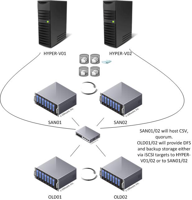

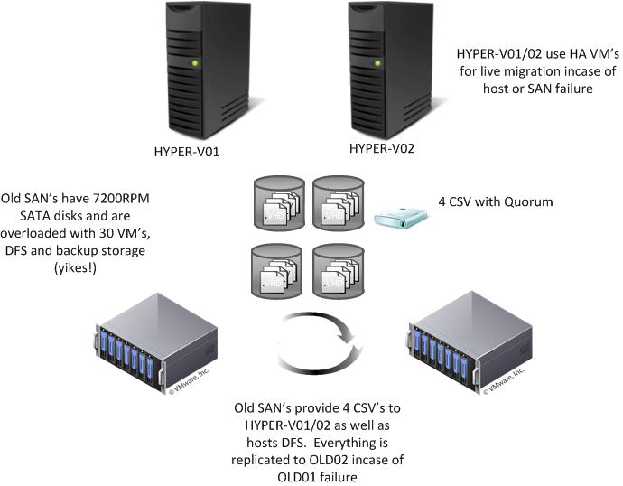

A client we currently manage has decided to upgrade their existing 2 SAN's (OLD01/02) to 2 new SAN's (SAN01/02) with faster drives. OLD01-02 are running Starwind Version 5.6 and are configured with HA images connected to HYPER-V01/02 via iSCSI (native Windows iSCSI initiator). OLD01 replicates data to OLD02. OLD01/02 also provides DFS storage as well as backup storage for VM's using Backup Exec 2010R3. The performance has been very very poor (not Starwind's fault, the SAN's just do to much and have slow disks), to the point of unusable at times. The new SAN's will have 36 600GB 15K RPM SAS drives, and I would like to use RAID 10 instead of RAID5 which is currently being used on the old SAN's. Also, the OLD SAN's I believe only have 1 large RAID5 array configured, we will not be doing this on the new servers.
We would like to install Starwind 5.8 onto the new SAN's, but I would like a little bit of help on the best way to migrate the HA/CSV images to the new SAN's, as well as any pointers you might have.
Thanks a bunch!
The current setup is attached as well as the setup we would like to use once the upgrade is completed.

HYPER-V01/02 details:
Dell PowerEdge T710 dual Xeon X5550 72GB RAM
Server 2008 R2 SP1
Using NIC teaming
OLD01/02 details:
SuperMicro server running Storage Server 2003
Using NIC teaming
SAN01/02 details: Don't have all the details on the hardware yet, server is due to arrive in a week or so
Server 2008 R2 SP1
