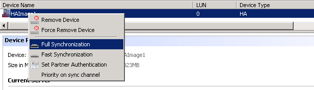

8.Initiate FullSync (in this case server1 should be the source of data, other words you need to initiate it from server2 host in SW management console as it is shown on the picture below)

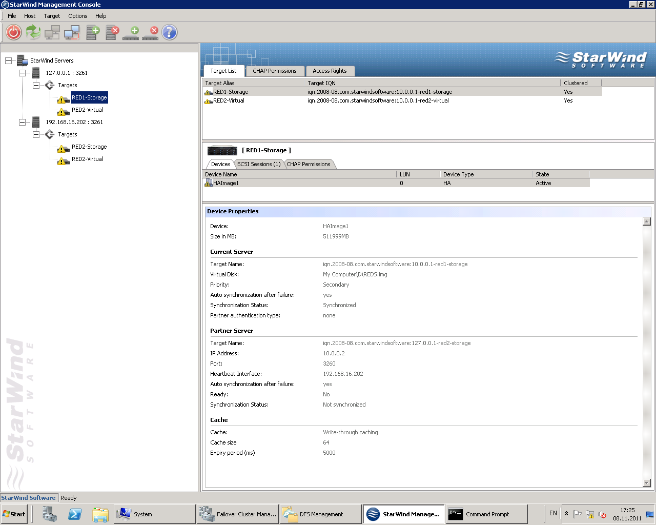

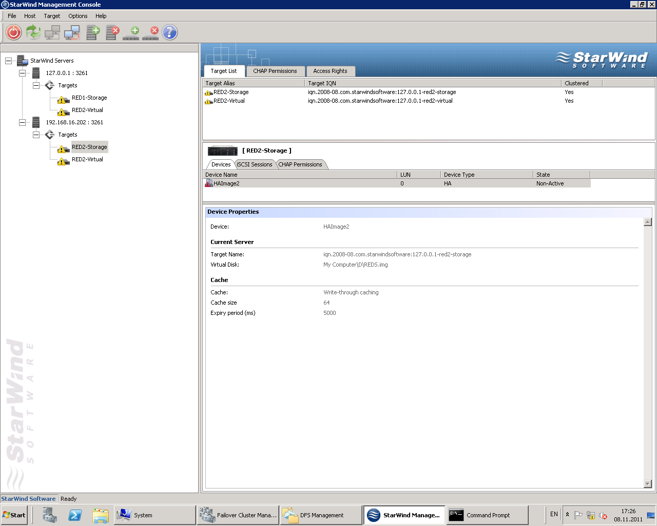

On broken node i see very short list of properties - maybe this can help?
properties on the working node (node 1)
properties on the broken node (node 2)
