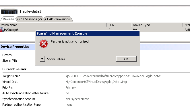

If I attempt a fast synch I receive this error:
fast synch error.PNG (19.93 KiB) Viewed 24957 times

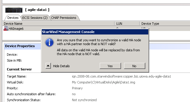

If I attempt a full synch I get this error:
full synch error.PNG (21.01 KiB) Viewed 24960 times
These errors happen no matter which server I attempt to start the synchronization on.
If I choose the full synch and agree to the warning the drive does eventually become synchronized.
