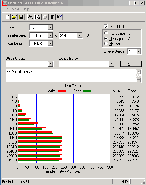

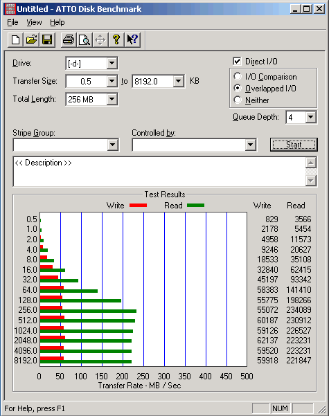

ATTO test
Mirror Enabled
No Mirror Enabled
