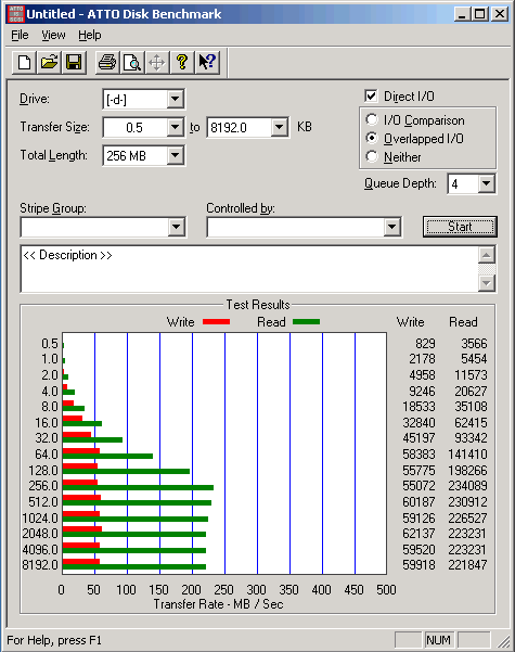

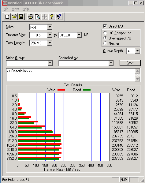

ATTO test
Mirror Enabled
No Mirror Enabled
Max (staff)
Posts: 533
Wed Jun 08, 2011 7:55 pm
What is the cache size you use on the primary host? and what is the cache mode you've set for the second mirror (not the image but the target you're selecting in the wizard when creating the mirror device)
Try to set the second mirror to Replication mode, this should increase the write performance, also the cache should be at least 128MB♠
