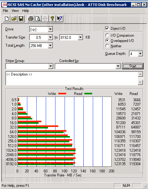

I have a few other Starwind installations that have never performed amazingly well, but they are at least usable.
Here is one of the other installations with average hardware and 1Gb connections…. (ATTO run on the iSCSI target)
iSCSI target (other installation).png (28.64 KiB) Viewed 33435 times

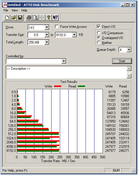

Here is what I get on my current installation with much better hardware all around…. (ATTO run on an iSCSI target, RAM disk)
1Gig RAM Disk.png (32.91 KiB) Viewed 33439 times
Anyone out there that can benchmark their setup and let me know what they are getting?

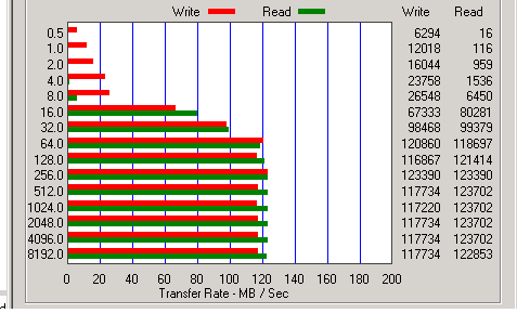

As for the results...this is before changing (or adding since it wasn't in the registry) the registry entry:
And this is after:

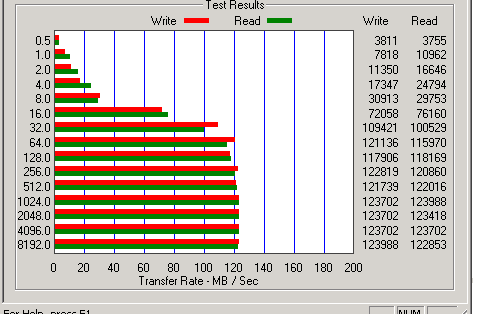

Default is a 200ms delay, the entry removes this and fires it off right away. My understanding is the default waits until the frame fills up (jumbo) to send the request and after 200ms sends it anyways.
The odd thing is if I set queue depth lower than 3 in Atto the performance is OK.

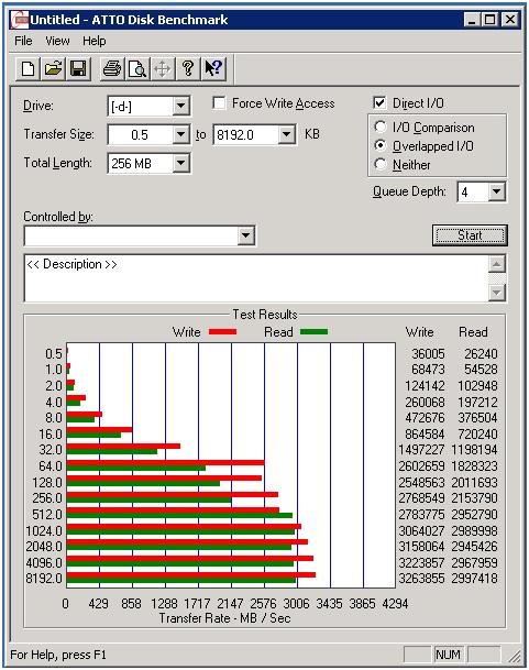

Internal RevoDrive Performance

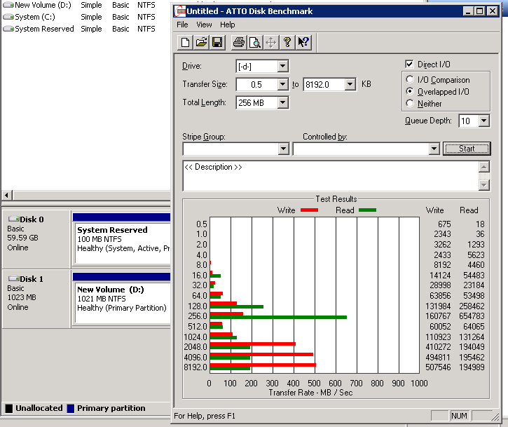

Over ISCSI Prior to registry change
Over ISCSI after to registry change
So I am at least now at 50% of expected performance I will be happy if I can get another 30% over ISCSI.

Following the benchmarking server guide. I created a new virtual disk on the RevoDrive x2.
The first benchmark is of the revodrive’s performance on the local machine.
The second image is the revo performance I was receiving prior to applying the TcpAckFrequency registry fix.
The third image is the revo performance after applying the TcpAckFrequency registry fix.
The TcpAckFrequency fix really should be a part of iscsi jumbo frames 101 :D
