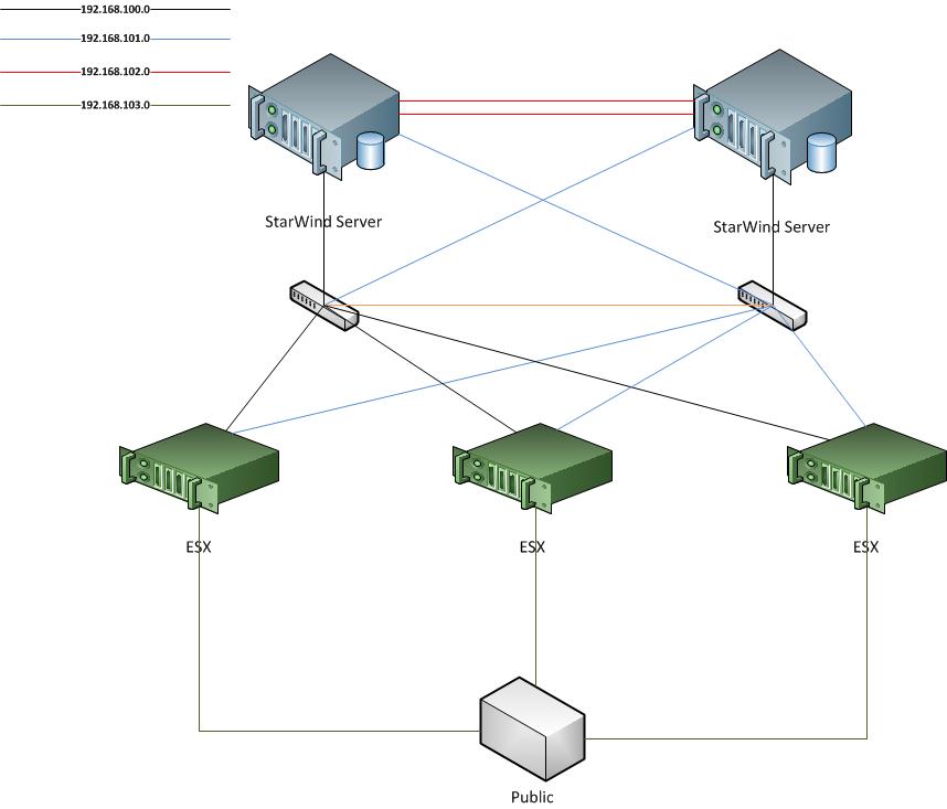

Hello guys i need some help
i cant wrap my head around this.
i am seting up starwind in a 2 node HA with 3 ESXI boxes
all five boxes have 4 Gb ports for san traffic
i have defined 4 subnets
192.168.100.0 ,101.0 ,102.0 and 103.0
each of the five computers will have 1 port in each subnet
my question is,, i have 2 managed switches in a stack for the SAN
how should i do the cables and vlans
right now there is 1 port in a vlan for switch managment and all the the others in a second vlan
there will only be san traffic on these 2 switches,
should i make 4 vlans for each of the for subnets ? is that really needed?
how would you plug the cables up ? put all off sub net one on switch one and all of sub net 2 one switch two and all of sub net 3 on switch one and all of sub net 4 on switch 2
or all four ports of node one on switch one and all four ports of node 2 on switch 2 and the spread the four ports of the esxi boxes accross both??
and id you did it that way if you used vlans you would have to set vlans accross both swiches....
there just seems to be 6 ways to sunday here please advise
thank you
Clayton

Hello Clayton
I`ve attached recommended scheme for your system
Please note that interfaces between StarWind Servers are used for synchronazation channel and used to be bounded and connected directly. Also switches are connected in order to increase fault-tolerance of your system.

the 4 ports I listed are just for San Traffic
each server has 2 four port cards plus 4 ports on board but your diagram will help
4 port to each switch
4 port to each other for the replication link
and 4 onbord ports for managment ,lan connetions, ip-kvm ect.
but what about the Vlans on the switches do i need them
Thu Mar 10, 2011 8:53 pm
You don't really need VLAN thing as whole iSCSI network should be run outside DMZ. I would go for dedicated SAN fabric / hardware however. Mostly b/c of performance.

this is want i set up today before i saw your post
so far i have just loaded server on both and got all the swiches set up
so i dont know if it will work but unless i am missing somethign it should work well.
Fri Mar 11, 2011 9:11 am
I think that me and Anton gave you pretty detailed recommendation, but your plan will work too. Please note that you have no need to use four vlans to connect to SANs.
