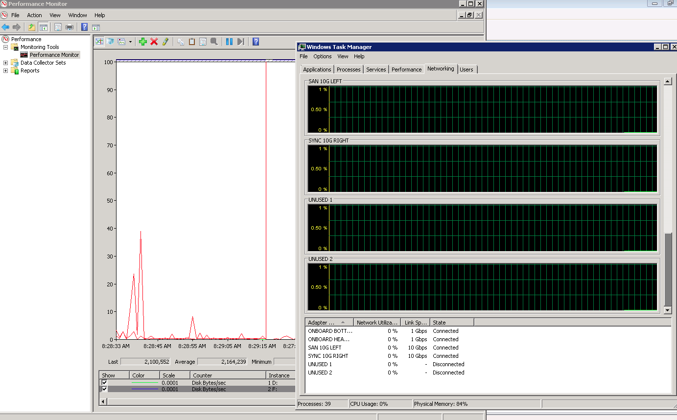

I think I may have found a problem...
...just don't know the solution. If I have Write Cache turned on for my Starwind targets, they can only flush to disk at exactly 2MB per second. I tested writing a 500MB file directly to the storage over the same SAN link and it wrote it almost instantly. If I write that same file through iSCSI to Starwind it appears to write instantly on the Hyper-V host, (because it writes to the Starwind cache), but then if you watch Perf-mon on the Starwind host it will only flush out to disk at 2MB per second?
Is this normal?
Screen shot 2011-03-06 at 8.29.07 AM.png (60.62 KiB) Viewed 30597 times
Max (staff)
Posts: 533
Wed Mar 09, 2011 11:08 am
This is not normal, I have escalated the case however we haven't yet managed to reproduce the issue.
