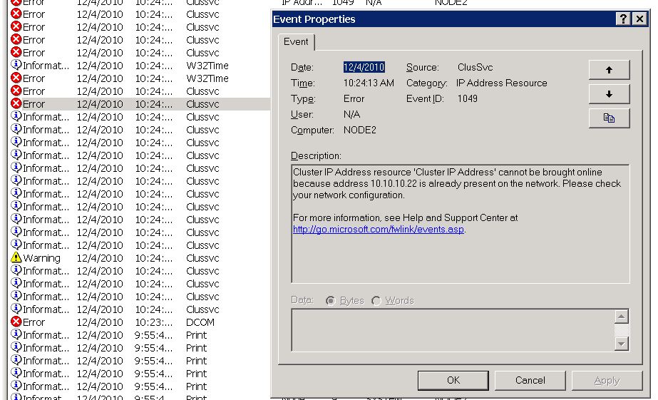

Setup an iSCSI server By Starwind 5.4 on Win7, and two Win 2003 VMs as cluster nodes on vSphere 4.0. Using the Starwind way to setup Quorum and another disk shared between 2 VMs. The way is that on each VM by Microsoft's iSCSI initiator to get the two shared disks directly from iSCSI Server (win 7). When setup a cluster on any node, get the info on picture 1
cluster 1.JPG (31.08 KiB) Viewed 35496 times

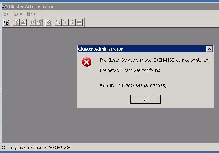

. At the end of setup, get the error info: The network path was not found (picture 2)

, checked Win system logs, get the info on picture 3
cluster 5.JPG (141.23 KiB) Viewed 35494 times
. Before and after it, check the 3 NICs' IP and ping them, all of them are good. After put new IP Address/subnet mask on the NICs which are for heartbeat, the problem is still there.

Constantin (staff)
Mon Dec 06, 2010 3:52 pm
According to MS KB you have choosen IP for cluster that already is assigned to another NIC.
Link to KB http://technet.microsoft.com/en-us/libr ... S.10).aspx

Constantin (staff) wrote:According to MS KB you have choosen IP for cluster that already is assigned to another NIC.
Thanks. I got it!

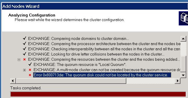

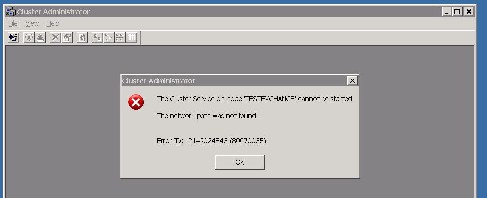

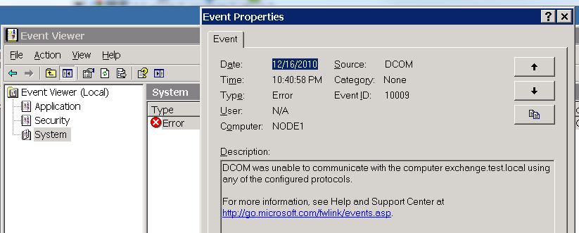

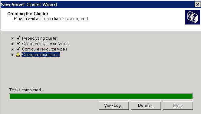

But now, there is almost same problem at the end of configuration. After click the buttom Finish, get the the error message, please look picture 1. clock OK on it, get almost same error message. And, on systen log, there is a DCOM error. Please look picture 3.

But, I also get another info which is different with MS's MSCS document. please look picture 2. The difference is that on MSCS document, here are 4 Marks. But, you see, I get only 1 Mark.
Is it a problem?

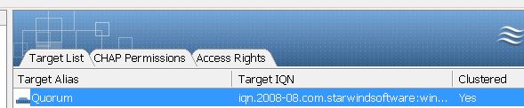

Now, I fixed the proble. But, after added second node, got another error message:
The quorum disk could not be located by the cluster service.please look the picture 1.
I checked the Starwind, the disk created on Clustered. Please looked the Picture 2.
and Computer Managerment on Win2003 on both nodes. Please looked picture 3.
Every thing lokked fine.
What is the problem?
Thankks!
Max (staff)
Posts: 533
Wed Dec 22, 2010 9:18 am
Did you doublecheck that the drive is connected to both servers?

georgeyu100
Posts: 33
Joined: Wed Jun 02, 2010 2:31 pm
Thu Dec 23, 2010 4:07 pm
Max (staff) wrote:Did you doublecheck that the drive is connected to both servers?
Yes, I can write a file down on the disk from both nodes.
