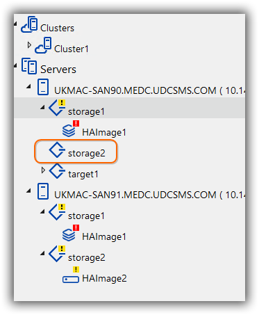

robnicholson
Posts: 359
Mon Sep 22, 2014 12:13 pm
Rather worryingly in that last test of clean shutdown and power-up, node #1 lost one of it's devices as well. See attached screenshot.
I have been messing around a lot with the lab here so I'm going to re-create all the storage.
Cheers, Rob.
