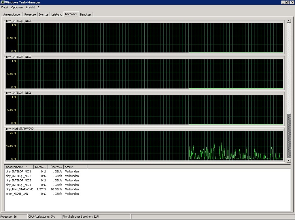

I tested a full sync with one target, its very small because it contains the hypervquorum. Its 10GB.
I attached a screenshot of my syncperformance, as you see it is juming up and down in average 2-3% of 10Gbit.
Normaly it has to be 10% of 10Gbit, and it was ... sometimes.

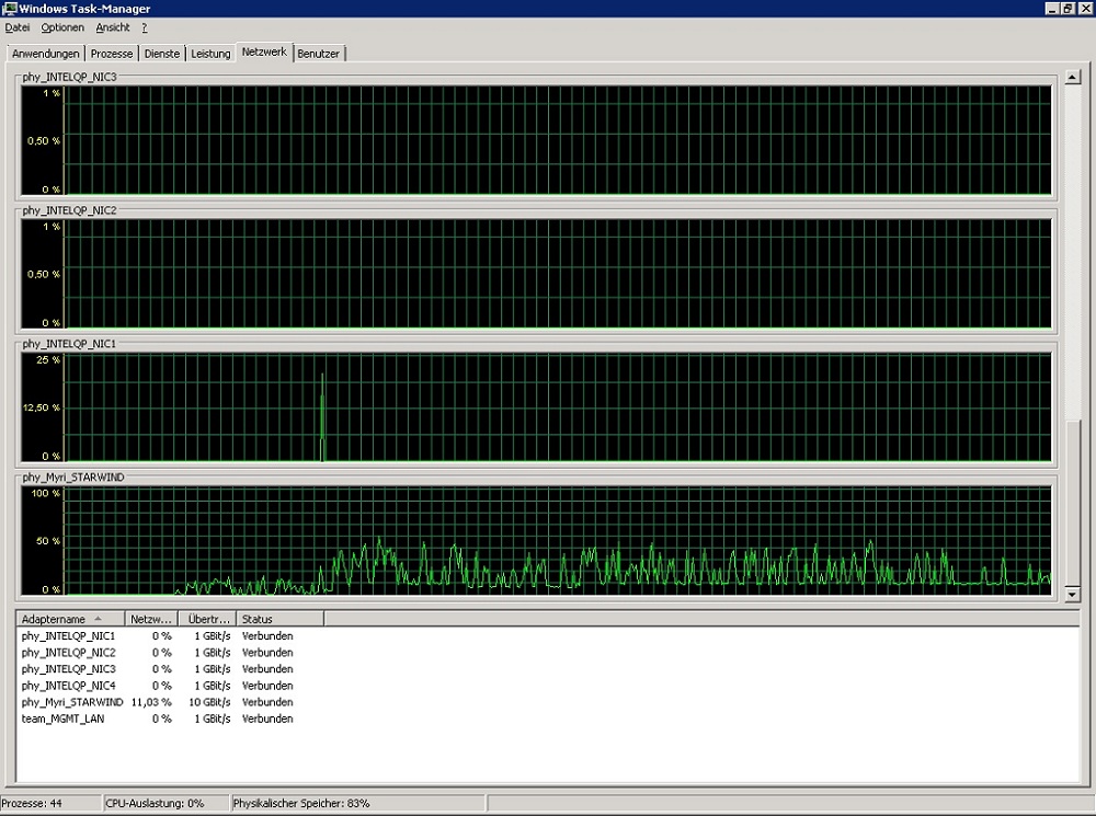

I now do a full sync of all 6 targets you can see below how slow it is. It should be at ~60% ...
I now have no more ideas ...
I need some help with this.

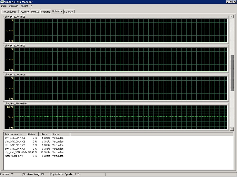

Okay guys, I found the solution for the sync problem.
I had to enable the Receive Side Scaling (RSS) in the Myricom 10GBe Network Card.
The RSS queue is 4.
The global settings posted here http://www.starwindsoftware.com/forums/ ... t2293.html did not work (I have set this settings directly after the first starwind installation!).
The settings were not set for the Myricom Network Adapter.
If you wish I can post all my network card settings for the sync adapter.

To be clear, this resolved the sync speed issue, as far as I can tell for now.
If my performance issue is resolved I can test tomorrow - the full sync will taks ~8h.
Something else I noticed, I started the HyperV Cluster and 9 VMs on it. The full sync is still in progress.
Ths sync speed seems to be affected ny this, it drops a little bit during the VM start (to arround 40%) but is now at 50% again.
