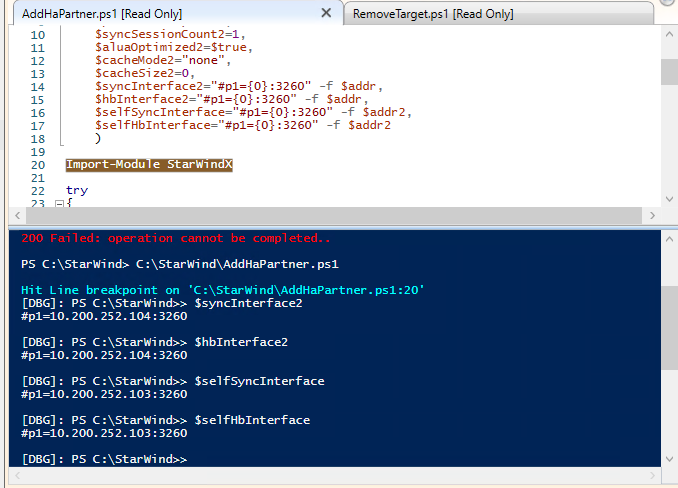

I think, that is not a solution, since the parameters are substituted correctly. Please see a screenshot below.
Are you blocked restoration functionality for free version?

This script enables to restore the HA device synchronization partner. Please fill in this form to log a new case https://www.starwindsoftware.com/support-form. Please use this forum thread as the reference.
Let us take a closer look at this issue together.

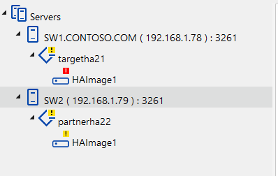

Below is an short explanation how to recover functionality after a disk failure.

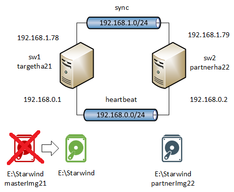

For example we have the following environment:
At this time we have replaced failed disk, assign the same letter for it and have created a folder for images.

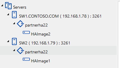

The screenshot of StarWind console:

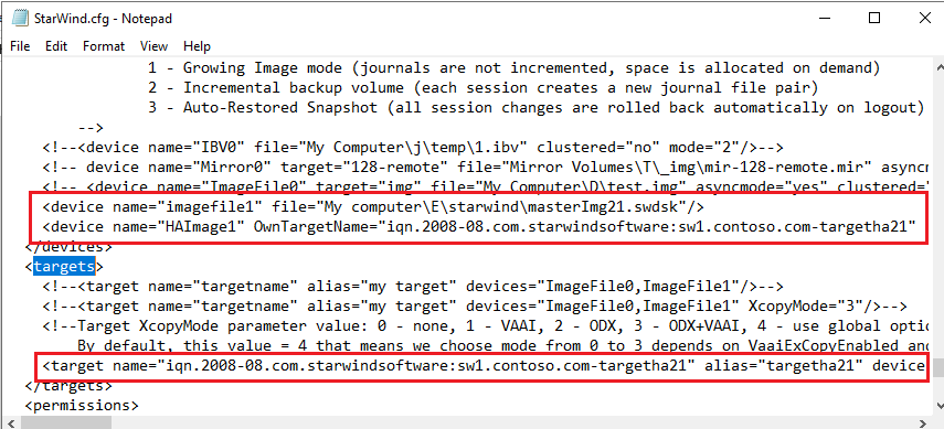

At first, we need to delete any information about failed devices from StarWind.cfg. To do this, we need to stop StarWind Virtual SAN Service before editing StarWind.cfg. Else, after restarting service an old records will appear in the file again. I suspect, that the service writes it in the file from memory during stopping.
So, in my case, you can see records that should be deleted on the picture below:

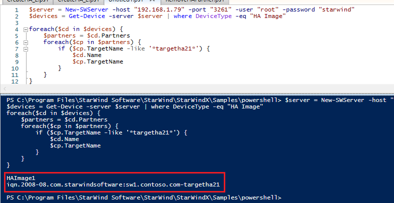

Then, we need to delete failed HA partner, on healthy node. To do this we need to find device name and target name for failed device. You can to do this like on screenshot below:
Then we should delete this HA partner by using RemoveHAPartner.ps1 script that belongs in the StarWindX\Samples\powershell folder

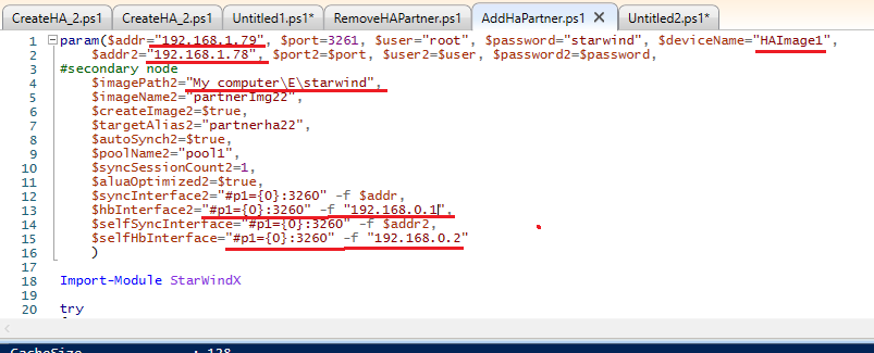

After that, we need start StarWind Virtual SAN service on failed node and add it as HA partner by using AddHAPartner.ps1 script
