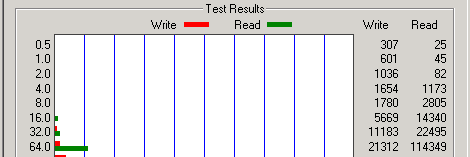

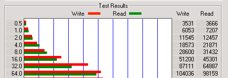

No if only I could get my installation to perform well. I have been instructed to use ATTO instead of IOMETER for testing and I ran it on an existing installation of Starwind that works fine, and on my problem child installation. (with much better hardware I must add) These tests were performed on the Hyper-V host (outside of any VM) directly to iSCSI storage running from Starwind.
First image you can see a nice linear progression of read/write speed all the way up to 64K on the existing installation.

On the second image I am reading at 25K a second at 512B Transfer length. I could run a VM off a USB stick and get better performance.

Any ideas, I am at the end of my rope....

Please, provide more details about targets you are testing here.
What are these images you are testing?
Where are you measuring the performance from?
Which RAID are used for first image and for second image?
Please note that on the screenshots you added there are no Transfer rate, it would be good to see it too.
