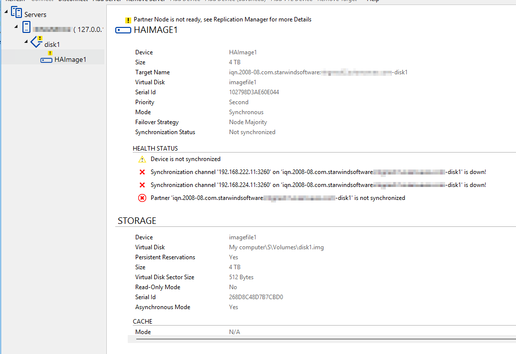

I got both nodes online, synced, everything seems to be working, but I'm running into an issue with the HA behaving as true HA.
When Node 2 reboots, Node 1 detects the down server and storage still works, as a single node with node majority due to the SMB share witness.
When Node 1 reboots, Node 2 suddenly says it's out of sync and storage disappears, all iSCSI connections go down. Once Node 1 finishes rebooting, Node 2 comes back online and and they get into sync.
It's like Node 1 is behaving as an "active" and Node 2 as a "passive" rather than mutually HA to each other.
How do I troubleshoot this? What config might be off here?

Screenshot of Node 2 while Node 1 is rebooting attached.

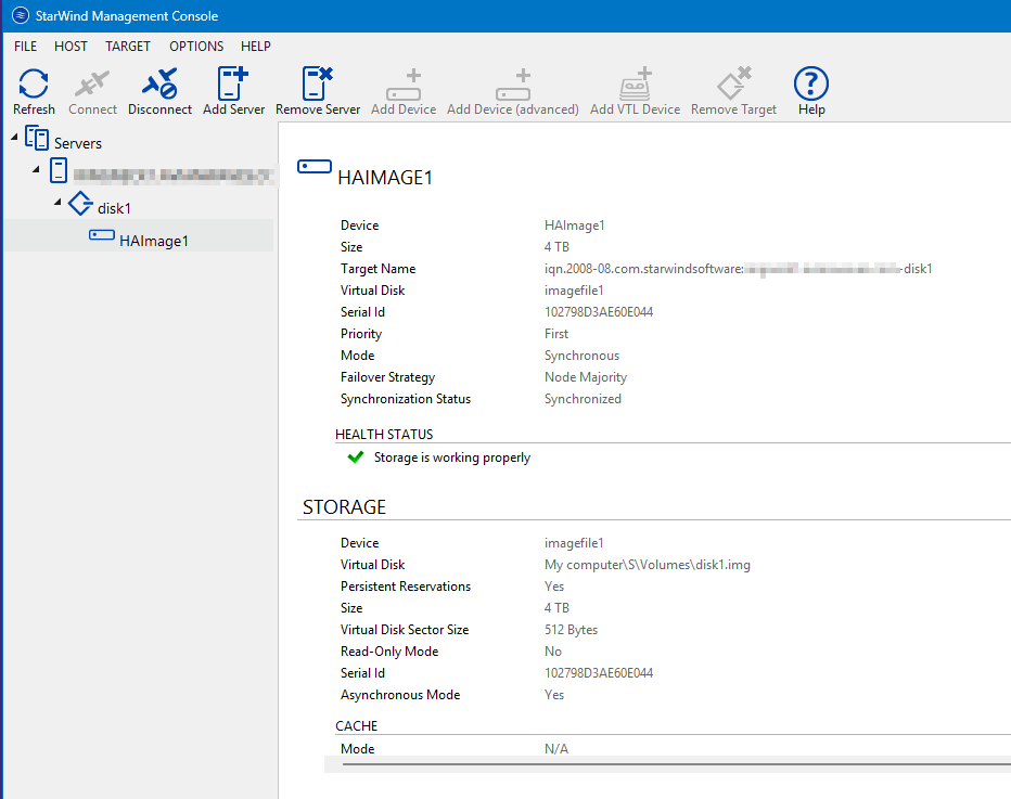

And Node 1 (for completeness) after reboot...
Posts: 4350
Fri Jun 26, 2026 6:35 am
That's expected. You have a 2-way replica configured with node majority. When one and the only replication partner goes down, the remaining partner gets isolated as it cannot confirm its sync status.
2 ways out of it.
1. Stop service on both nodes.
2. Go to _HA.swdsk for each node
3. Find <failover> area
4. Set to 0.
5. Start the service for both nodes.
Also, make sure that redundant network cards are used for replication node interfaces (i.e., sync and heartbeat). If there are switches or inter-site connections involved in StarWind SYNC and iSCSI, make sure those are redundant too.
