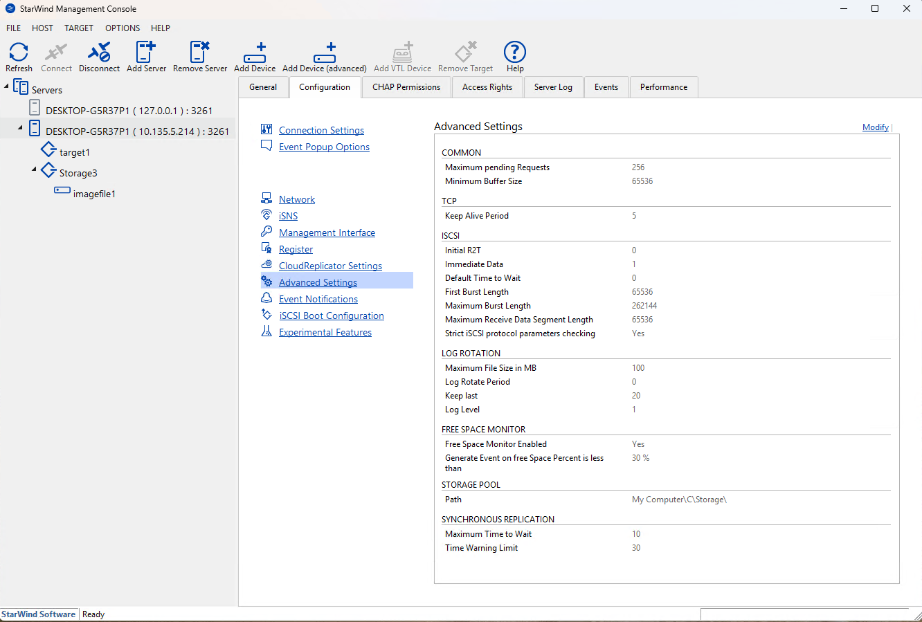

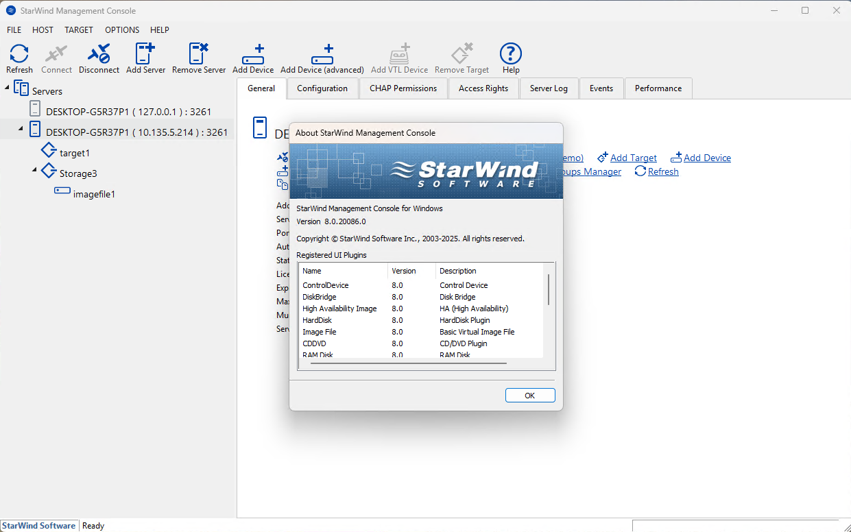

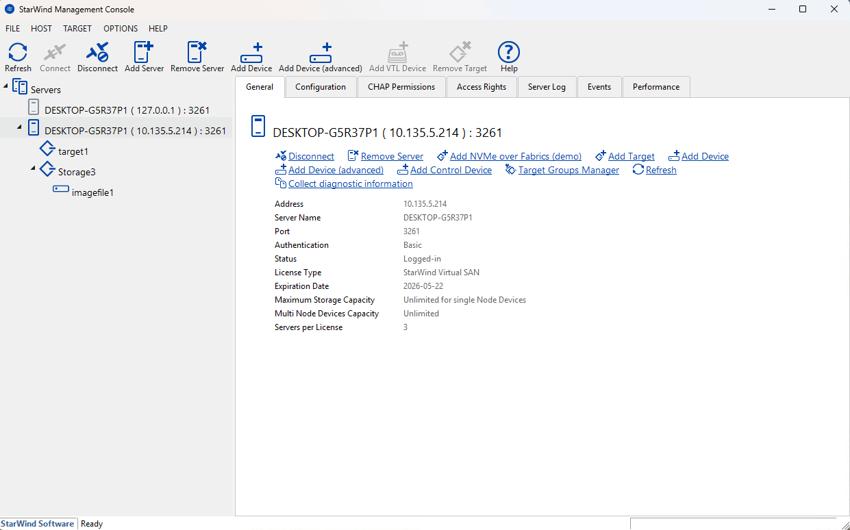

I'm attaching some screenshots of the Starwind VSAN free V8.0.20086 installed with Management Console.
Thanks a lot for your support.

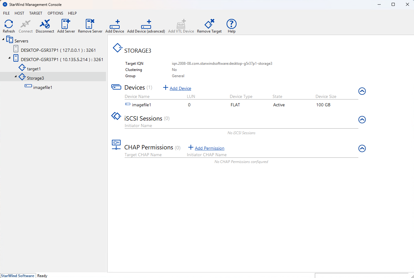

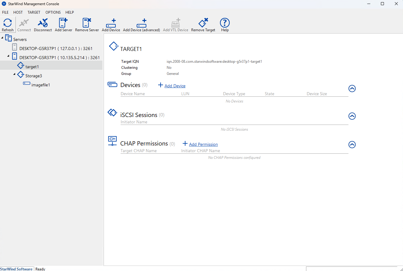

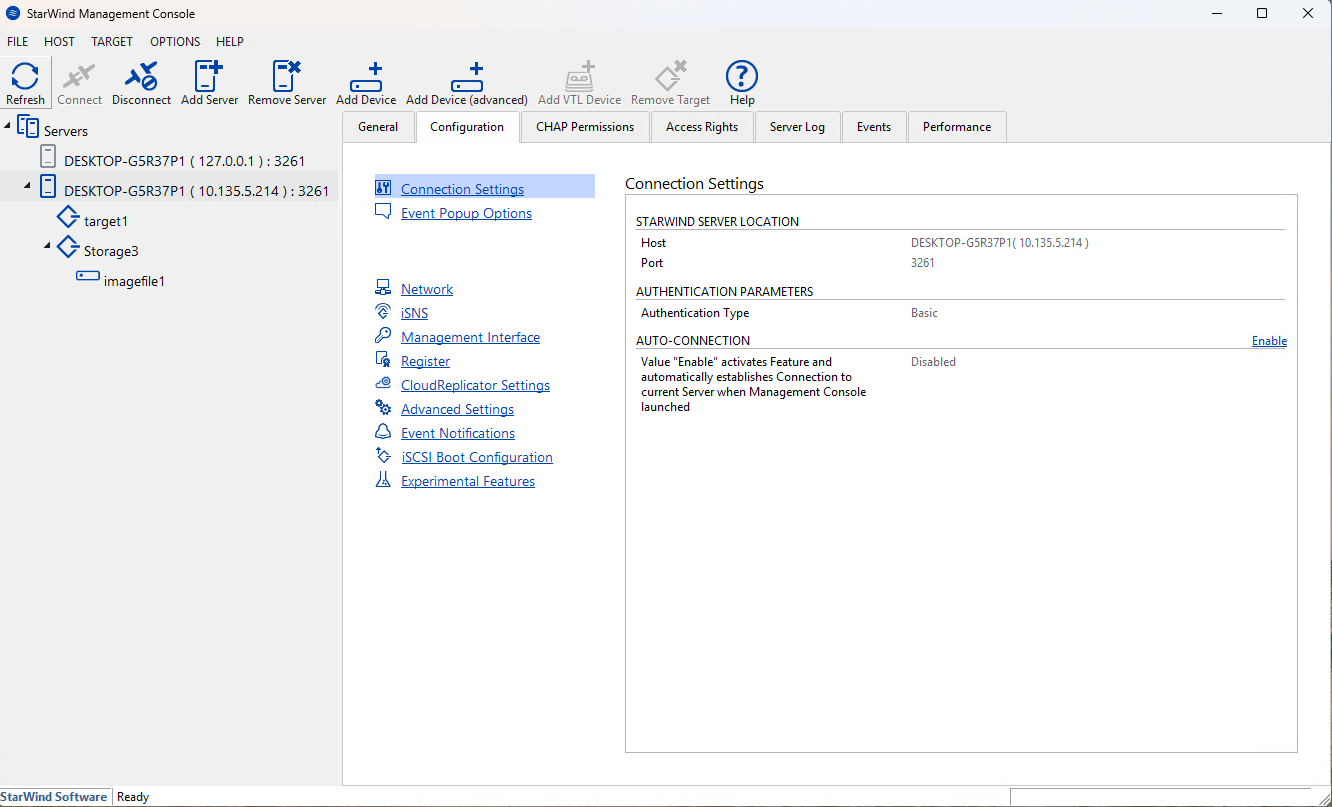

Now more tree screenshots because there is a limit to upload.
Please find attached.

ALUA settings are normally under the HAimage settings. They are not quite applicable to your case because ALUA settings are a feature of StarWind HA devices while you use non-replicated ones.
Quick question, so I can help you better. If you can access the replication wizard from the UI, you can get some support (my colleague will bring you in contact with the team). If the replication node interfaces are inaccessible, well, you are "stuck" with me here :D
