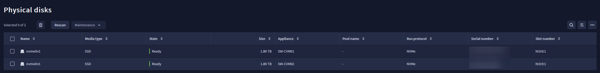

I´m currently trying to create a StarWind vSAN Storage pool in a two Node VMware Cluster.
I set up the two StarWind Appliances as described here . I also set the two NVME disks to passthrough in ESX and mounted them as PCI-E Device. In the disk overview the two disks are shown correctly.
Disk overview
Disk overview

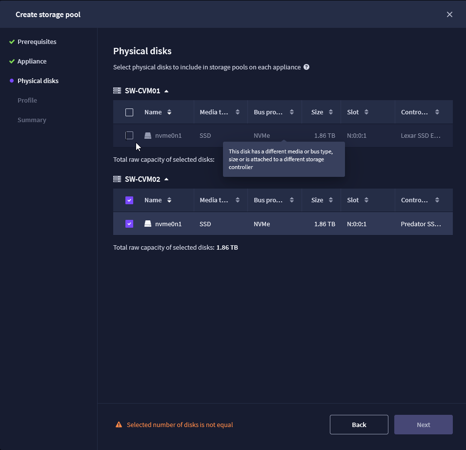

When I try to create a storage pool, I get the error message, that the disks has a different media or bus type, size or are attached to a different storage controller.
Pool error
Pool error
I doesn´t matter which disk I select "first". The error message appears everytime when I try to select the second disk.

Get this fixed by myself.
Passthrough the NVME didn´t work. I created a raw mounting in ESX. This worked.
Posts: 4510
Sat Apr 25, 2026 2:44 pm
Thanks for your update. You can create a pool for each node, i.e., remove them from the appliances and join at the next step.
