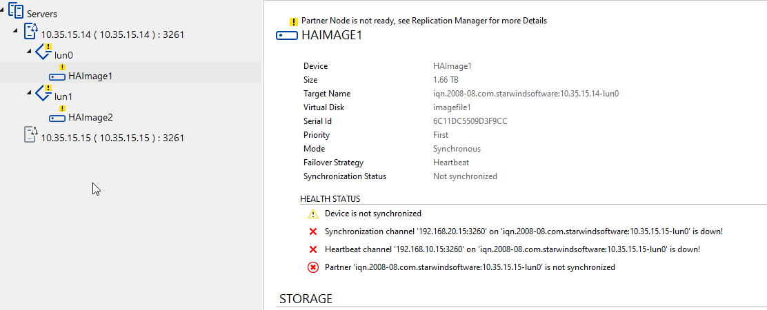

I am running starwind VHCA on a two node proxmox cluster, this all was working fine up until yesterday when a network adapter failed in one of my proxmox servers (pv02), even though it failed the vm's were still running there were just no connectivity on the host. I have 2 adapters on each host 1 single port 1g port that is used for mgmt of the proxmox as well as the vca appliance. The other nic is a dual port 10g adapter that was used for the data and replication on the host. I was able to get into the web interface of the appliances because those run off the 1gig interface (in the below it is the 10.35.15 network) and could see that the cluster was out of sync, on proxmox 2 it was showing the storage from the vhca was unavailable but on proxmox1 it was still showing available. So i shutdown the proxmox2 eventually replaced the nic and then noticed on proxmox1 it was showing the disk are offline. I have been trying several things to get this back up at this point i have shutdown the vhca on proxmox2 and is just working on the vhca on proxmox1 which should have been working fine, but I have the issue where the disk in proxmox show offline and look like it is not connecting via iscsi. If I try logging into the vhca on the proxmox host it is showing below and failing to login, which nothing has changed on this host, other then I created a [iface: iscsi-eth1] to see if that would work but it stopped working prior to that.
Any idea how I get these back connected? Also in the vhca 01 is listed as priority 1 and I have not rebooted or done anything to vhca01.
Below is the output of trying to login to the target.

Posts: 4309
Mon Sep 22, 2025 2:53 pm
Proxmox2 was out of sync, this is expected because of node priority when th eplication link fails viewtopic.php?t=5731.
What you can do is try re-discovering the storage over iSCSI in both proxmox hosts using iscsiadm discovery and login commands from the guide https://www.starwindsoftware.com/resour ... ng-web-ui/.
Also, please install windows-based console (starwindsoftware.com/tmplink/starwind-v8.exe), connect to both CVMs and see if any device is synchronized.
If none synchronized, try marking 01 as synchronized (follow this guide https://knowledgebase.starwindsoftware. ... -blackout/ and use this method viewtopic.php?f=5&t=7257&p=40082&hilit=Uncomment#p40082).
Try also pinging the IPs inside the VM.
Good luck!

ehinkle29
Posts: 23
Joined: Thu Mar 13, 2014 8:34 pm
Tue Sep 23, 2025 2:31 pm
I am running the appliances and it shows this via the management console. How would I mark as synchronized, i can't do that via the web gui?
https://i.postimg.cc/zDdm7BF7/node1.jpg
https://i.postimg.cc/PrBRV8pW/node2.jpg

Posts: 4309
Wed Sep 24, 2025 7:33 am
Did you have a chance to edit that script?
No need to rebuild anything. Just trigger full sync.
You can stop one cvm, run the script for the remaining one ans check data. As mentioned in the article, your pricedure should be stop one cvm > run script adjusted the way I described >check console to se if the right nodr is synchronized >rescan storage by running iscsiadm login > check vm data. If all good, start the node you stopped.
ehinkle29
Posts: 23
Wed Sep 24, 2025 12:46 pm
I have followed that step, shutdown node2, uncomment the section of the script as stated, but I still get an error when running the script and the system shows not synced.
Below is what that section of the script looks like
	if($device.SyncStatus -ne [SwHaSyncStatus]::SW_HA_SYNC_STATUS_SYNC)
		Write-Host "Synchronize device $($device.name)" -foreground yellow
		$device.Synchronize([SwHaSyncType]::SW_HA_SYNC_FULL, "")
		$device.MarkAsSynchronized()
	else
		Write-Host "Device $($device.name) is synchronized" -foreground yellow
catch
This is the error shown when running the script with the node1 ip address
PS C:\Program Files\StarWind Software\StarWind\StarWindX\Samples\powershell> C:\Program Files\StarWind Software\StarWind\StarWindX\Samples\powershell\SyncHaDevice_cust.ps1
Synchronize device HAImage1
Failed to perform synchronization (1) from
control 0x000000000118DA00 -Synchronize: -SynchronizationType:"1"
200 Failed: can't find available or valid partner for synchronization..
This is what it shows in the console and when I try logging in from the iscsi client it fails.
https://i.postimg.cc/0QCcfnFj/node1-aftersync.png

Posts: 4309
Wed Sep 24, 2025 1:35 pm
Please share the entire script with me and make sure that the password is root/starwind.
ehinkle29
Posts: 23
Wed Sep 24, 2025 3:21 pm
This is the script.
param($addr="10.35.15.14", $port=3261, $user="root", $password="starwind", $deviceName="HAImage1")
Import-Module StarWindX
try
	Enable-SWXLog
	$server = New-SWServer $addr $port $user $password
	$server.Connect()
	$device = Get-Device $server -name $deviceName
	if( !$device )
		Write-Host "Device not found" -foreground red
		return
	else
catch
	Write-Host $_ -foreground red
finally
	$server.Disconnect()
Posts: 4309
Wed Sep 24, 2025 7:36 pm
Is not commented in your script.
ehinkle29
Posts: 23
Thu Sep 25, 2025 10:26 pm
Okay, missed that, looks like that worked.
