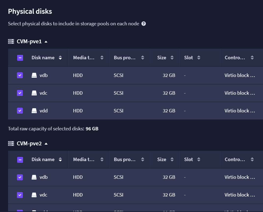

Hello all, i am on Proxmox (5 Node Cluster with Ceph right now), i wanted to try STarwind. CVM installation works without anyproblems. i then created 3 virtual disks in the CVM which are recognized by starwind, but when i want to set it to Raid 5 there is nothing shown. See Screenshot. Any clue what that could be?
thumbnail_image (1).png (85.46 KiB) Viewed 116 times
thumbnail_image (2).png (36.17 KiB) Viewed 116 times

Version on all 3 appliances is:
1.6.580.7361
what i can do i is only add each disk one by one into a raid 0.
Posts: 3606
Mon Jun 30, 2025 7:12 am
Welcome to StarWind Forum. Adding the VM disks in RAID will cause tons of overhead. That's why software RAID is not possible in a GUI. You can still RAID them via CLI, but it is not recommended.

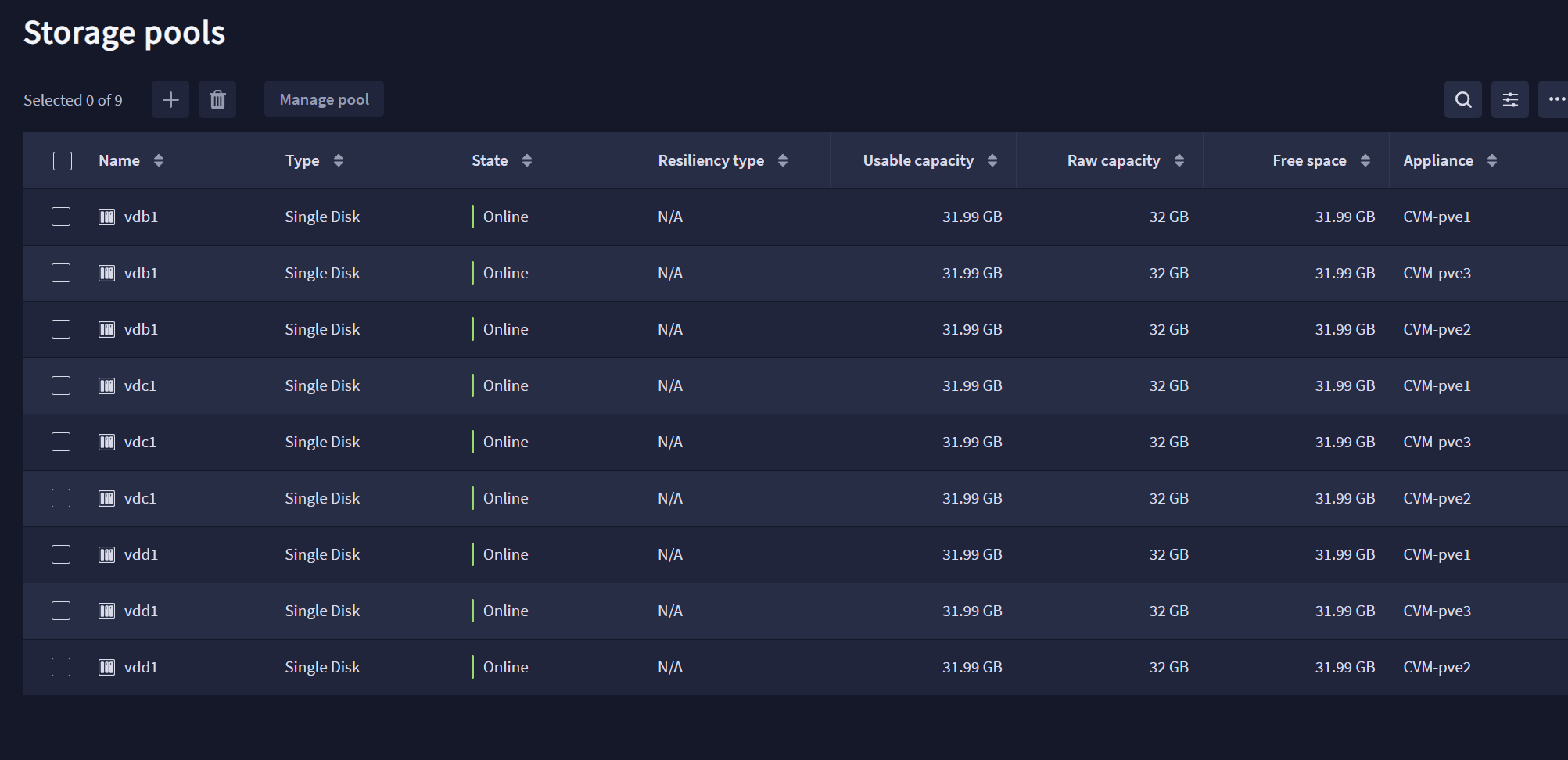

sorry then i got a bit mislead by the ZFS and G-Raid Option, i thought your logic is different from CEPH but that means generally its the very same, you distribute evenly accross nodes + all single (JBOD) disks each node.
So i have done it like this for test?
Generally does Starwind offer Siteawareness?
Screenshot 2025-06-30 145246.png (123.76 KiB) Viewed 63 times
Posts: 3606
Mon Jun 30, 2025 1:09 pm
If you have GRAID, the configuration process looks different. If you have GRAID, the hardware is to be passed into CVM and configured inside the CVM.
The configuration, like you showed earlier, allows creating 1 XFS partition for each device.
