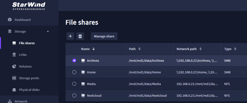

I am noticing that some users don't get execute permissions when accessing a VSAN SMB share in Windows. I have no idea what's causing this, but read/write always seems to be fine. Execute seems to be set to only one user, and it could be the administrator account, or it could be another user. This is causing issues with not being able to execute apps from the SMB share. Copying the apps from the share to a local PC and running works, but that's a real pain. When Security perms are viewed in Windows, there's a sambashare user (Unix Group\sambashare) that gets Read and Write perms, and then one other user local to VSAN (either a created user, or administrator) that gets Read & execute, Read, Write, and Special permissions. Any ideas what's going on and how to fix this?

StarWind VSAN does not create SMB shares. It does not create the special users either.
CVM can do NFS shares though.
Does your question relate to the SMB witness or NFS shares?
As a side note, SMB witness is not available for CVM.

Ok I must be thoroughly confused about something. What's the attached SMB share? It's a web interface for my VSAN.

I discussed this thread with my colleague (we need more time to prepare the workaround). Thanks for pointing this limitation out!
Also, as a side note, VSAN supports sharing options not only for NFS (sorry for misleading you).

We conducted a quick test in our lab and have reproduced the issue you described. I have requested our R&D team to implement a fix in the next release, either through a custom setting or as a permanent update for sharing. In the meantime, I have a workaround that will resolve the problem for you.

With regards to the provided screenshot, I assume the commands would be the following:
sudo chmod 0755 -R /mnt/md1/data/Archives
sudo chmod 0755 -R /mnt/md1/data/Home
