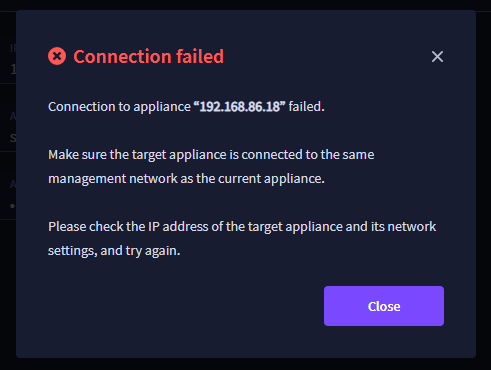

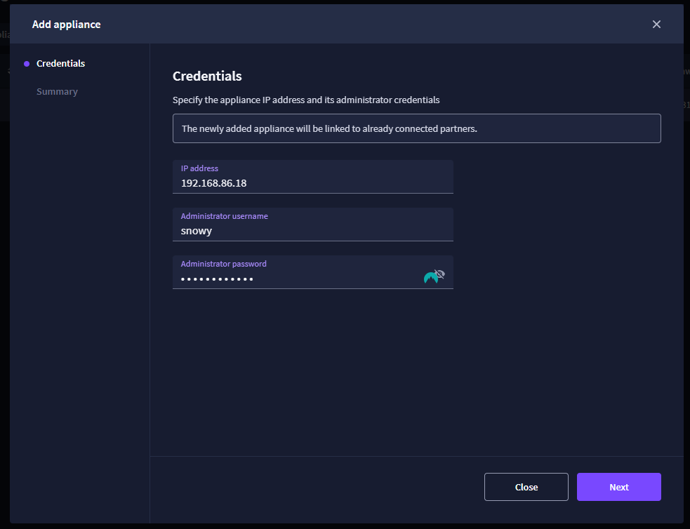

I'm trying to roll out 3 Starwind vsan nodes to act as my storage for my 3 node proxmox cluster + some of my vms (for docker/kubernmetes volumes, etc) but I seem to be having some issues adding the additional nodes as I keep getting this error.
adding appliance two.png (25.02 KiB) Viewed 10010 times
failed to connect to appliance two.png (18.03 KiB) Viewed 10010 times
failed to connect to appliance three.png (18.23 KiB) Viewed 10010 times

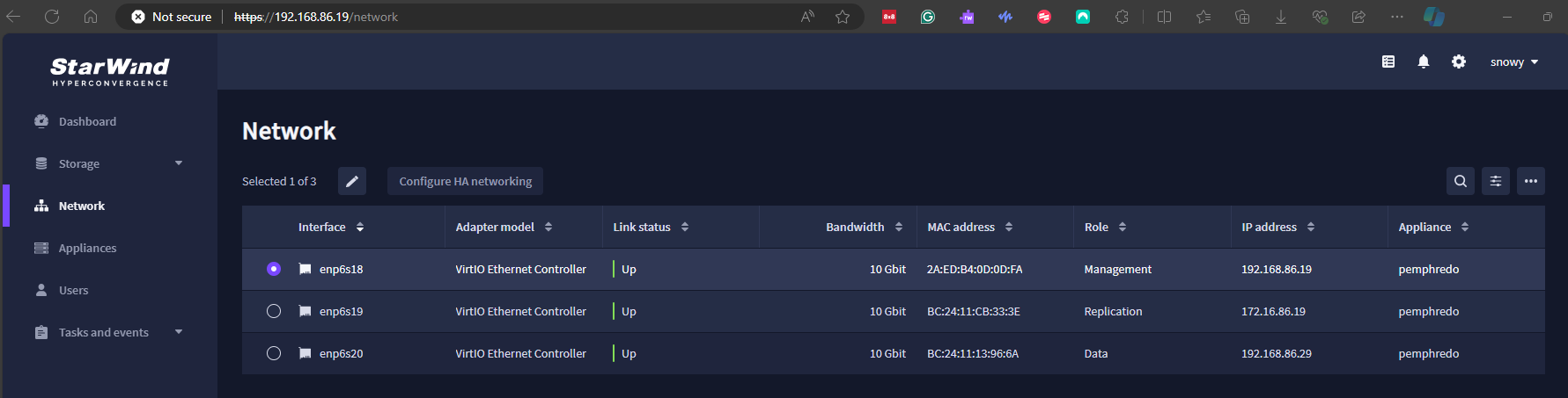

This network range is my main lan and I've checked that all 3 nodes can ping each other. The interface for IP shown is set as a management interface, but maybe I need add another management interface?
the docs say to input the management IP but maybe I should try with the replication network IP?
I don't have any storage configured on any of the nodes yet, Do I need to do that first?
I'm unclear as to the cause of the error and [the docs][/https://www.starwindsoftware.com/resour ... sing-web-u] aren't very clear what to do if joining the appliance shouldn't work.
Any help or advice would be greatly appreciated.
I can provide additional screenshots of the networking setup on each node if that helps.

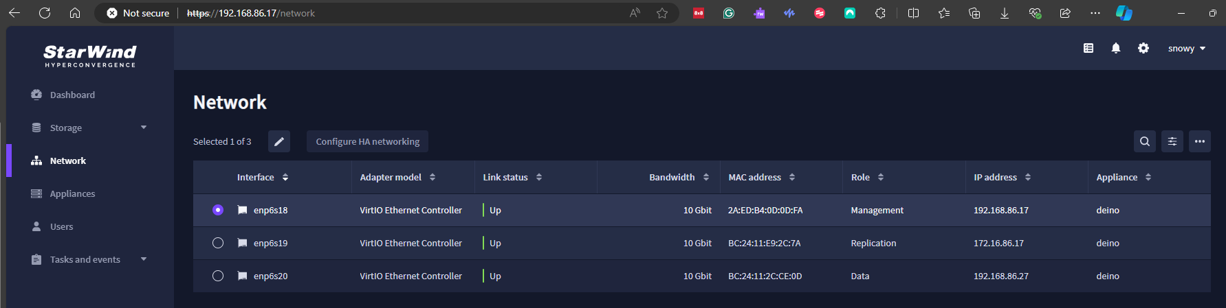

These are the networking configurations for each node
starwind appliance one networking.png (59.19 KiB) Viewed 10009 times
starwind appliance two networking.png (59.17 KiB) Viewed 10009 times
starwind appliance three networking.png (59.2 KiB) Viewed 10009 times
Let me know if you want to see the configuration within Proxmox, or any other information really.

I had a word with my colleague. It looks like the VM was cloned.
Please re-add the management adapters.
See more on cloning https://pve.proxmox.com/wiki/Duplicate_Virtual_Machines.

I've reset all of the mac addresses of the nic in proxmox and all 3 nodes will now connect to each other in the ui.
Posts: 3633
Mon Dec 02, 2024 1:36 pm
Many thanks for your update.
Yes, the issue was related to MAC addresses on the interfaces. That kind of conflict was causing havoc in ARP tables.
Thanks for your cooperation.

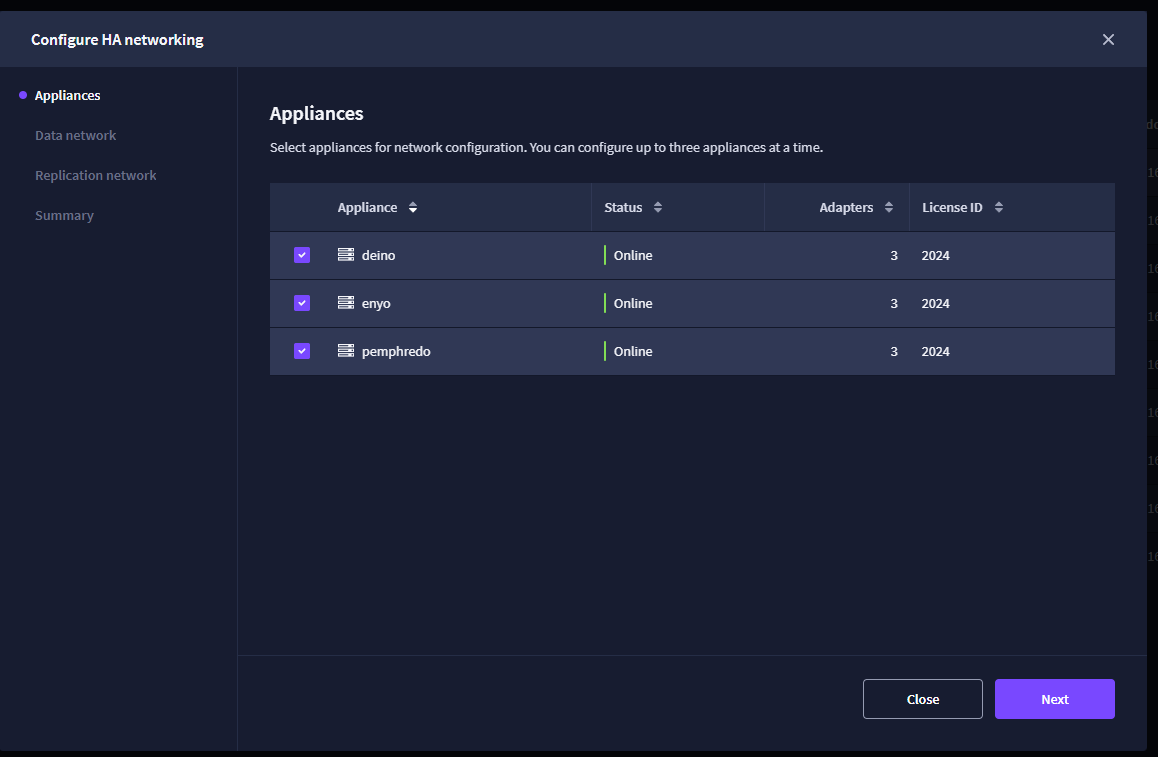

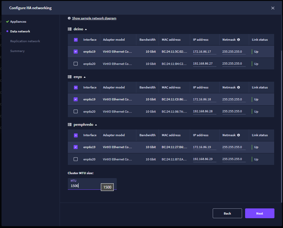

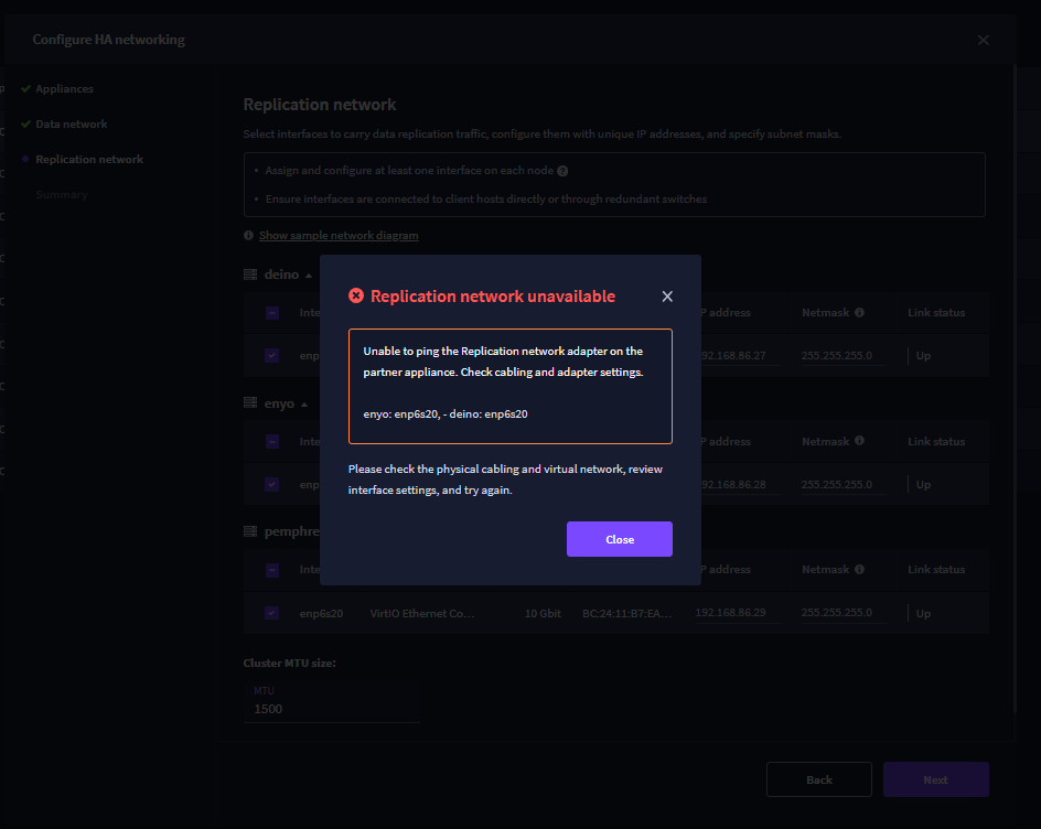

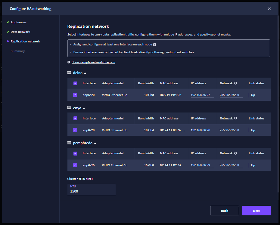

Okay so new issue, I'm trying to configure HA networking, which I'm not sure if I actually need. I can configure the data network fine but when I try to configure the replication network I get told it can't ping the replication network targets, I've logged in via SSH to each node and pinged the replication targets and they do respond.
Screenshot 2024-12-02 151842.png (28.27 KiB) Viewed 8047 times
Screenshot 2024-12-02 152323.png (46.69 KiB) Viewed 8047 times
Screenshot 2024-12-02 152841.png (47.17 KiB) Viewed 8047 times

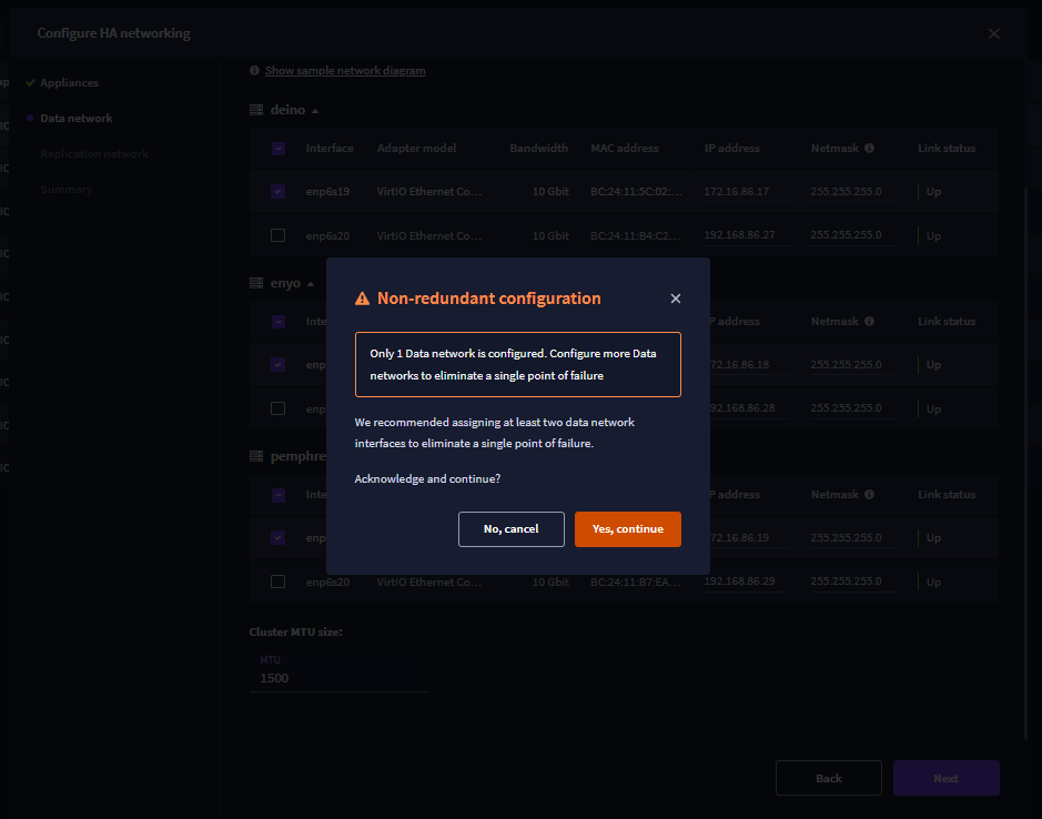

I get this warning when I only have 1 data network selected, but I seem to be able to skip this step.
Screenshot 2024-12-02 152343.png (50.78 KiB) Viewed 8045 times

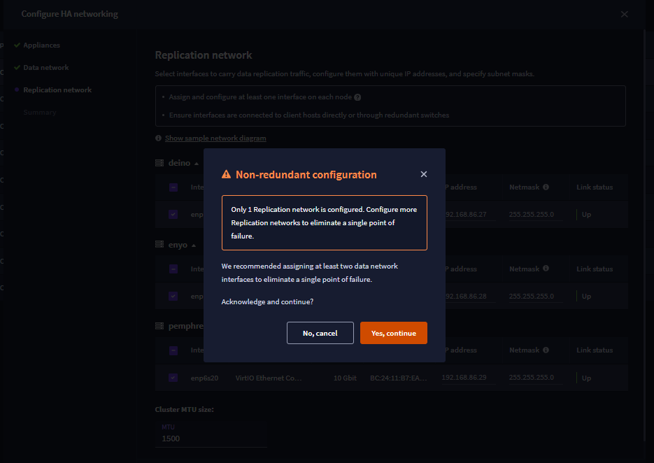

I also get a similar warning when I try to set the replication network, but it looks like i can bypass that as well
Screenshot 2024-12-02 154000.png (50.15 KiB) Viewed 8045 times

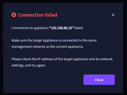

but then i get this error, despite when pinging the targets via the starwind consoles I get a response
Screenshot 2024-12-02 153618.png (50.82 KiB) Viewed 8045 times
