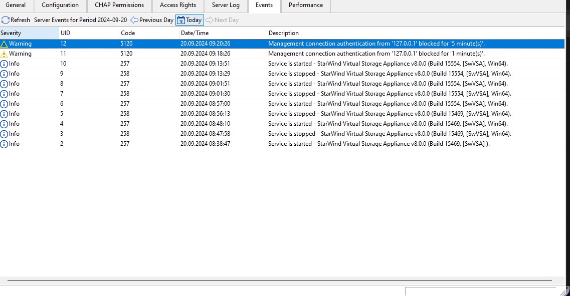

hi. in 2 node vsan esx cluster, when i change management password on two nodes after installation i get nodes blacklists each others.
so sync fails.
what was i do wrong?

i did clean install first node and changed root password from legacy gui and i get this right away

when i change password to "starwind" no blocking messages.

and snipet of logs
9/20 9:31:17.124507 39 Srv: TelnetListener::listenConnections: Accepted control connection from 127.0.0.1:36928.
9/20 9:31:17.143115 47 Srv: ControlConnection::processConnection: start processing 127.0.0.1:36928
9/20 9:31:17.147212 47 Srv: ControlConnection::processConnection: finish 127.0.0.1:36928
9/20 9:31:17.147240 47 Srv: ControlConnection::stop: 127.0.0.1:36928
9/20 9:32:17.144345 39 Srv: TelnetListener::listenConnections: Accepted control connection from 127.0.0.1:49512.
9/20 9:32:17.145275 48 Srv: ControlConnection::processConnection: start processing 127.0.0.1:49512
9/20 9:32:17.145595 48 func: >>> iScsiServer::sendNotification
9/20 9:32:17.145608 48 func: >>> CEventDataBase::AddRecord
9/20 9:32:17.145610 48 EventDB: CEventDataBase::AddRecord: Code 5120, severity 2, additional strings: 2
9/20 9:32:17.145627 48 func: <<< CEventDataBase::AddRecord
9/20 9:32:17.145629 48 Srv: iScsiServer::sendNotification: Send reaction start (reaction type 2, msg code 5120).
9/20 9:32:17.145643 48 Srv: iScsiServer::sendNotification: Send reaction finish.
9/20 9:32:17.145646 48 Srv: iScsiServer::sendNotification: Send reaction start (reaction type 1, msg code 5120).
9/20 9:32:17.145730 48 Srv: iScsiServer::sendNotification: Send reaction finish.
9/20 9:32:17.145734 48 func: <<< iScsiServer::sendNotification
9/20 9:32:17.145738 48 Srv: ControlConnection::doLogon: Username or password you entered is invalid.
Authentication attempts from '127.0.0.1' address are blocked for 5 minute(s).

The log is not sufficient. Can you pull the entire support bundle?
Please also reach out to support@starwind.com: Trial users still get support :) Use 1218400 and this thread as your references.
Are you concerned about blocking notifications? This is a known issue, but it never affects synchronization.
I do not see it affecting synchronization or the server either.

but annoying connection blocked on legacy client is continue in latest release
also webgui says sync failing after change password but it is not. and luns state goes to limited availability. if i go legacy client everything is fine.

Management password is a pain for logging in and WEB UI. Not for sync.
Wait for the next build (there should be NVMe-oF too) for the Management auth improvements.
