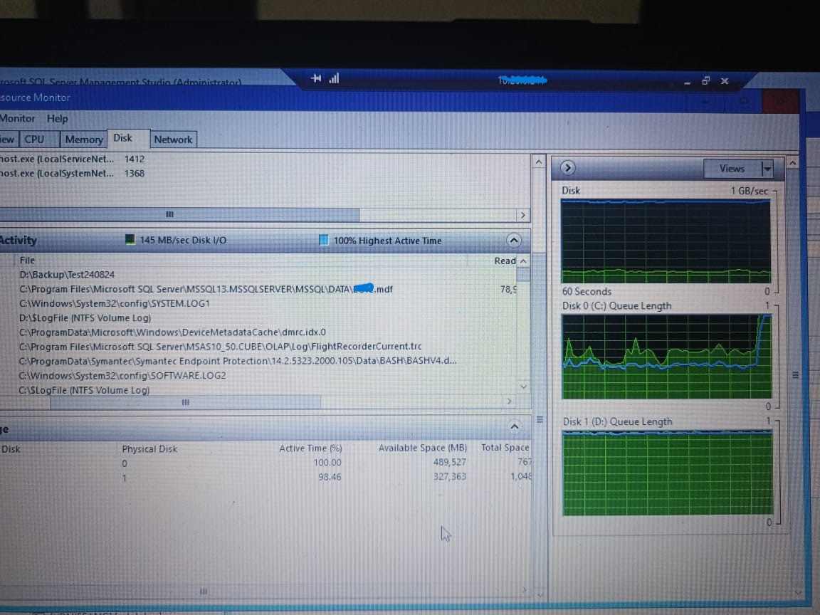

I'm currently facing an issue with my SQL Server VM where the performance is noticeably slow, especially during certain queries. I've observed that the disk utilization spikes to 100% during these operations, which is causing significant delays.
I suspect that there might be some configuration settings that need to be fine-tuned to optimize the performance. Has anyone experienced a similar issue or can you suggest specific adjustments that could help mitigate this problem?
Any advice or recommendations would be greatly appreciated!

Mon Aug 26, 2024 9:25 am
Thanks for your update. Just general ones:
Does the VM have any snapshots?
Is its disk fixed?
Did it start happening after the outage?
Could you try enabling a write-back cache for the RAID controller?
Try shutting down the VM and playing around with CPU allocation (NUMA, Hardware topology, etc).
Make sure the NIC drivers are up-to-date.
Try assigning more local iSCSI sessions for StarWind HA devices.
Make sure MPIO is set to LQD on both nodes.

Mon Aug 26, 2024 9:36 am
NOP
Is its disk fixed?
they are thin virtual disks
I don't think so
I will update the configuration
I need to do some research about it since I don't know what to do exactly here, I have assigned 16 cores for this VM.
They are up-to-date.
I'm using the MS Windows iSCSI initiator (2 sessions), do you recommend using Starwind iSCSI Accelerator? Is it straightforward forward to install it? does it need to restart after the installation?
The least Queue depth is already configured.
Mon Aug 26, 2024 5:45 pm
Try thick disks, enable write back controller cache, and play around the CPU allocation.
You can add more loopback sessions as described here https://www.starwindsoftware.com/resour ... c3bac25222. This does not need downtime. Do it for CSVs.

Tue Aug 27, 2024 12:02 pm
Quick update:
We changed the RAID configuration from RAID5 to RAID10, and SQL performs very well.
Changes made without any impact:
- Enabled write-back cache on the raid controller and played with the cache ratio 60% read 40% write / 50% read 50% write. no luck!
- Added more sessions also no luck!
Last question about Starwind iSCSI Accelerator, does it require a system restart to take effect?
