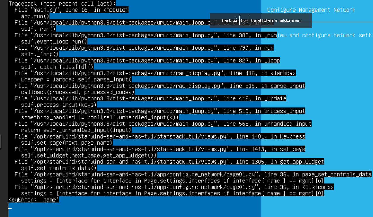

When I add two more virtualized adapters, there is only a blank screen on the webgui telling me: "Management service is starting. Please wait..." after starting up.
Attached screenshot is what appears when i go into the console and try to set the management network manually.
