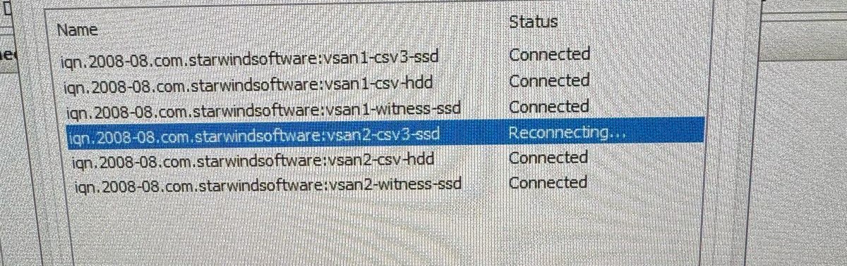

The storage is availabe and it does switch path if iSCSI initiator is "active". Do you see the CSV going offline?
NOP, I see only reconnecting message to one CSV out of 3 and this CSV hosts most of the VMS.
starwind reconnecting.jpg (253.33 KiB) Viewed 28855 times
After rebooting the storage, everything will be healthy. it is happening once per week.
there is a network misconfiguration, most probably or MPIO is not working well.
what to check exactly? MPIO configured as per your recommendation.
Posts: 3571
Sun Feb 25, 2024 6:48 pm
Thanks for more info!
This whole thing does not relate to MPIO (i focused on MPIO as a part of best practices). Reconnecting state means that the storage is not being published for a given target. It is normal behavior if synchronization drop happens for instance.
This is not meant to be dangerous as StarWind HA storage is available from the other node and the production continues to run happily.
Please share the logs from both storage nodes with me and provide roughly the time when this happens.
Also, just to make sure we are on the same page. Are you trying to troubleshoot the reconnecting state, issues returning back to syncheonization, or storage outage (downtime)?
Also, did you try to observe the reconnecting state for 30 mins? Last but not least, is it a storage node that is restarted?

1. Does reconnection and sync drops happen during backups?
there are random hourly backup jobs throughout the day/every day. and the issue is not happening daily.
2. Does reconnecting state go in 30 mins after being discovered?
I have no answer
3. Do delays precede synchronization drops?
I have no answer for that, because we used to run after user complaints that they lost access to some applications hosted on the VMs. we quickly start restarting the services etc...
4. Do you have write-back cache on your devices?
We have write-back cache enabled on the raid controller for this SSD logical volume / RAID5
Also, the strip size/full stripe size for this volume is 64KiB/256KiB. is this an optimal value for SSD logical volume?
Also, we have HPE SSD Smartpath enabled for this logical volume.
Posts: 3571
Mon Feb 26, 2024 10:43 am
Thank you for your update.
Can I please have the full set of logs?
It does not look like an issue related to StarWind VSAN as there would be CSV-scale outage otherwise.
Thanks for your update.
Try disabling write-back cache (https://knowledgebase.starwindsoftware. ... -l1-cache/) and updating StarWind VSAN (https://knowledgebase.starwindsoftware. ... d-version/). Get StarWind VSAN latest build for Windows https://starwind.com/tmplink/starwind-v8.exe.
P.S. Check if stopping a service on one node leads to VM downtime.
