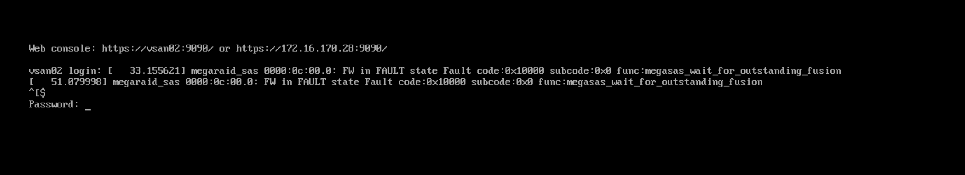

i install vsan free on 2 host with sphere 8.0:
- both host has same storage, some ram, ...,
- i add to vsan vm with passthrough the megaraid sas controller
- heartbeat and isci connections are on dedicated spf+ switch without connection to client/server network, MTU 1500
- sometimes 1 node crash for error on controller with megaraid_sas FW on Fault State, megasas_wait_for_outstading_fusion
After this crash i not be able to start this node.
Only solution that i found is to remove HA partner...
Could you help me?
Luca
Error Log
Error Log
Screenshot 2022-11-22 alle 09.57.38.png (133.98 KiB) Viewed 7344 times

It seems to be a general Linux error saying that the device cannot be recognized (in time). Please rescan the ESXi storage and reboot it again.

i make following step:
1) i reboot esxi host,
2) after restart with "idrac" (dell server) i see both controller sas is ok
3) i start esxi
4) both controller sas is ok
5) i start starwind vsan virtual machine
6) vsan crash with same error on controller
i make this test 3 times with same result.
two days ago i had same issue on other esxi host.
Posts: 4510
Tue Nov 22, 2022 4:38 pm
Did you rescan the storage before starting the VM up?
