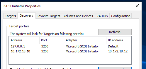

Hello yarorslav,
thanks much for your fast response.
HA_swdsk: Would you be kind enough to point me to the files location?
As for my question regarding iSCSI Initiator, your guideline shows multiple iSCSI targets added in the iSCSI inititiator while I only added two (local node and remote node).
Do you recommend that I add the remaining interfaces (so the second 10GBit Interface of each other node on both sides) for redundancy in the Initiator?
It greatly depends on the storage. For SSDs, 2x local and 2x partner connections are OK. For 2x Partner iSCSI links you can use 1x iSCSI Session per partner. Adding more links to iSCSI Initiator provides better load-balancing but it is mostly done for redundancy.

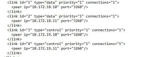

One last question: After checking the config file, all interfaces (2x Heartbeat and 2x Sync) have been correctly set up in StarWind (please see attached image).
Though I still get a load distribution on Node One on both Sync Interfaces while the first sync interface (strangely not the second one) sits idle.
Do you know where else I could look? Or do you think that this behavior is normal?

Posts: 4510
Fri Jan 21, 2022 10:31 am
The load should be distributed between sync links according to Round Robin.
An additional synchronization link does not provide performance boost but just network interface redundancy.
