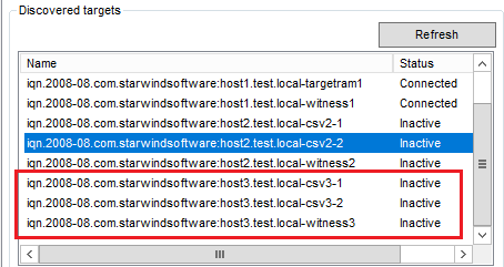

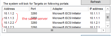

Additionally, I have two hb/iscsi links in different subnets and when I add two iscsi target portals (two links) i have only links for first portal.
How should I configure two links from the same host for redundancy?
Could you kindly elaborate on this? Seeing a screenshot will be just great.

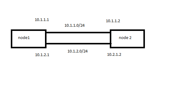

I've iscsi/sync infrastructure like this:
The only difference, that I have three node (10.1.1.3 and 10.1.2.3)
You can see my list of targets below:
and my links:
As you can see, host 3 have only one link for each image, but has two iscsi network links for redundancy
Do iSCSI and Synchronization go over the same channels? Your diagram does not meet our recommendation on dedicated iSCSI and Synchronization links.
No, I have two separate dedicated 25 Gbit/s links for iscsi/hb.
