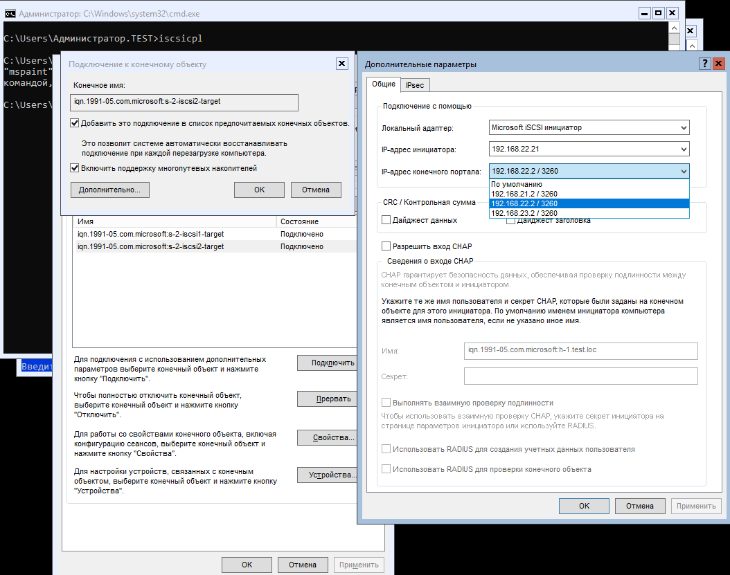

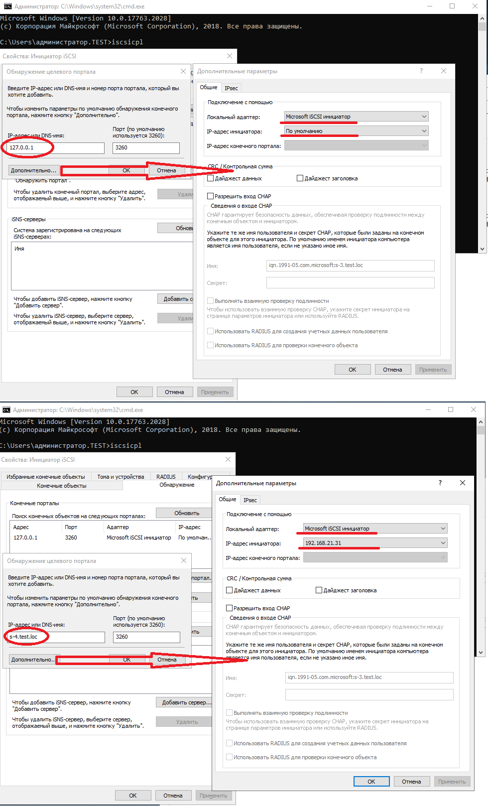

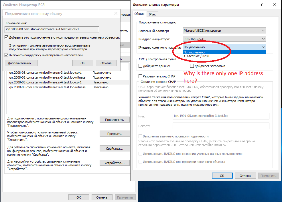

1. You have two instructions on the site:
starwindsoftware.com/resource-library/starwind-virtual-san-for-hyper-v-2-node-hyperconverged-scenario-with-windows-server-2016/
starwindsoftware.com/resource-library/starwind-virtual-san-for-hyper-v-2-node-hyperconverged-scenario-with-hyper-v-server-2016/
Please explain why for target "Witness" in Connecting Targets => point 3 you DO NOT CHECK the "Enable multipath" checkbox? BUT for target "CSV1" in Connecting Targets => point 6, do you CHECK the "Enable multipath" checkbox?
I looked at video instructions on the internet, everywhere there is a CHECKBOX for ALL targets.
Why is the setting for a quorum disk different?
What should be the correct setting?

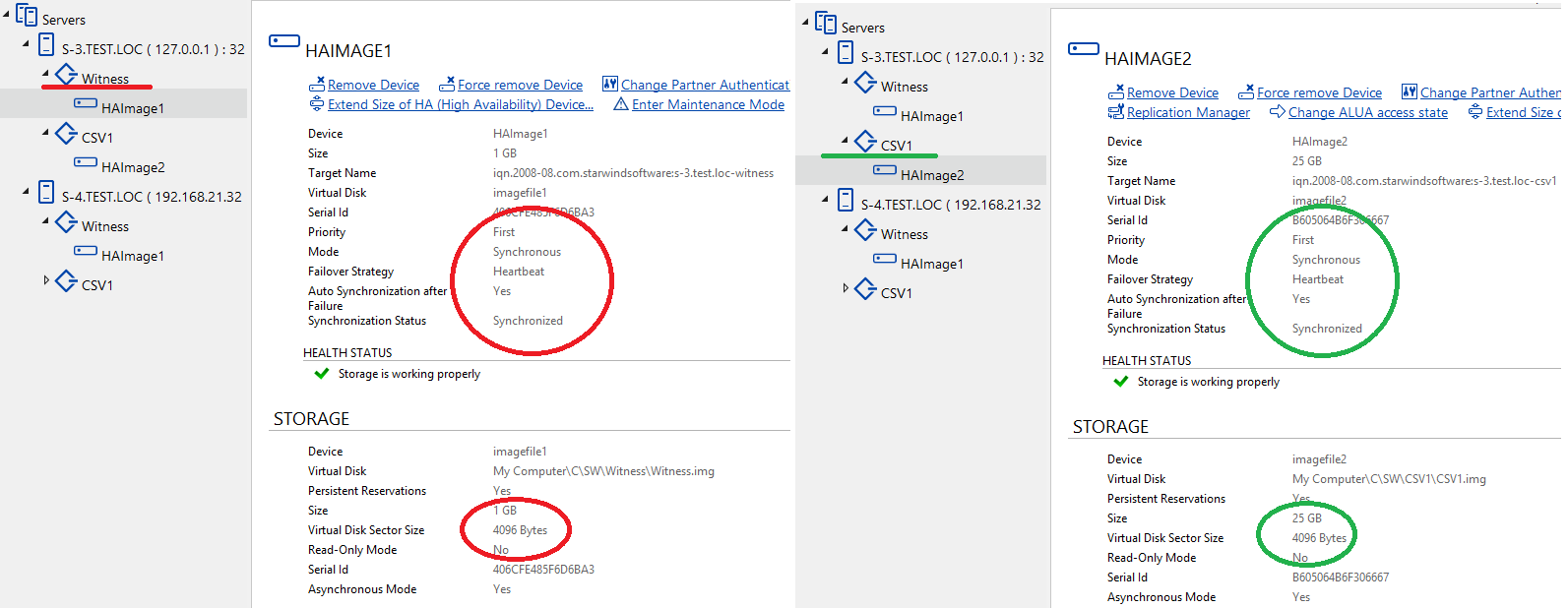

2. Which cluster size is better than 512 or 4096?
----- Hyper-V NTFS -----
----- StarWIND * .img -----
----- Hyper-V * .vhdx -----
----- Guest NTFS -----
In NTFS, the default is 4096
From the link it is clear that vhdx is also 4096
docs.microsoft.com/en-us/windows-server/administration/performance-tuning/role/hyper-v-server/storage-io-performance
The guest virtual machine also has NTFS 4096.
If you choose * .img 512 cluster size when creating a StarWind target, you get the following:
----- Hyper-V NTFS (4096) -----
----- StarWIND * .img (512) -----
----- Hyper-V * .vhdx (4096) -----
----- Guest NTFS (4096) -----
It seems to me that when creating a StarWind target, it is better to choose 4096, then you get the following scheme:
----- StarWIND * .img (4096) -----
The cluster size in all cases is the same 4096.
What cluster size is the best choice and in what scenarios does 4096 incompatibility appear?

Posts: 4508
Mon May 17, 2021 3:28 am
Welcome to StarWind Forum.
1. Multipath is to be enabled for the Witness HA but it is to be connected only over 127.0.0.1.
2. For Windows, 4096 block size is better but a 512b device will also be available to the system. I'd rather use 4096 size for a target presented to Windows, while only 512 is to be used for targets presented to ESXi.
3. Mixing traffic as you do for Ports 1 and 2 is not recommended. Use individual NICs for iSCSI and Sync. Make sure to have 2x NICs as described here https://www.starwindsoftware.com/system-requirements. One port can be used for iSCSI/Heartbeat/Live migration alone, while other ports are to be used for Sync and Management/Heartbeat/Live migration respectively. Also, we do not recommend teaming iSCSI and Sync links.
Finally, we recommend direct connections when it's possible. Please consider plugging Sync and iSCSI NICs directly.
Let me know if you have additional questions.

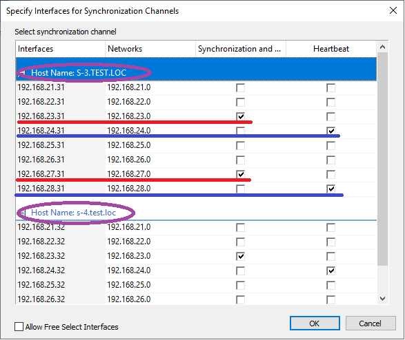

And there were several questions about the StarWind cluster network operation.
When configuring a StarWind cluster at https://www.starwindsoftware.com/resour ... rver-2016/ in " Heartbeat "in point 5 when configuring the network, the interfaces for" Sync + Heartbeat "and" Heartbeat "are selected
An additional "Heartbeat" is configured so that if the "Sync + Heartbeat" interface is damaged, a split brain does not work, as written at the link https://www.starwindsoftware.com/blog/w ... and-how-to -avoid-it /
(Q3) How does StarWind choose which interface (if multiple interfaces were selected in the "Specify the interfaces for Synchronization and Heartbeat Channels" setting) will synchronization and heartbeat occur?
(Q4) Do you plan to remove "Heartbeat" in future versions, replacing it with "Sync + Heartbeat"? For example, a Hyper-V cluster does not have a dedicated "Heartbeat".
(Q5) If only "Heartbeat" stops working, will the pulse be transmitted via "Sync + Heartbeat"?
(Q6) Is it possible in StarWind to manually (force) prioritize (if the primary (high priority) interface is damaged, it switches to the backup (low priority) interface) to select the clock and heart rate interfaces?
(Q7) Do you plan to add priorities for choosing interfaces for synchronization and heartbeat in future versions of StarWind?

1. Поправить инструкцию(отметить checkbox "Enable multipath" для target "Witness") в инструкции по ссылке starwindsoftware.com/resource-library/starwind-virtual-san-for-hyper-v-2-node-hyperconverged-scenario-with-windows-server-2016/

I created a virtual test cluster of two windows server 2019 according to the following scheme:
node1(s-3.test.loc) node2(s-4.test.loc)
NIC1(192.168.21.31) === switch1 === NIC1(192.168.21.32) - Client access to guest VMs(Production network) + H-V(Management) + SW(Management) + H-V(Heartbeat + CSV Sync)
NIC2(192.168.22.31) ============== NIC2(192.168.22.32) - iSCSI (traffic)1 + H-V(Heartbeat + CSV Sync)
NIC3(192.168.23.31) ============== NIC3(192.168.23.32) - SW(Sync+Heartbeat)1 ONLY
NIC4(192.168.24.31) ============== NIC4(192.168.24.32) - SW(Heartbeat) + H-V(Live migration)1
NIC5(192.168.25.31) === switch1 === NIC5(192.168.25.32) - Client access to guest VMs(Production network) + H-V(Management) + SW(Management) + H-V(Heartbeat + CSV Sync)
NIC6(192.168.26.31) ============== NIC6(192.168.26.32) - iSCSI (traffic)2 + H-V(Heartbeat + CSV Sync)
NIC7(192.168.27.31) ============== NIC7(192.168.27.32) - SW(Sync+Heartbeat)2 ONLY
NIC8(192.168.28.31) ============== NIC8(192.168.28.32) - SW(Heartbeat) + H-V(Live migration)2
I did everything according to the instructions, but in the item "Provisioning StarWind HA Storage to Windows Server Hosts" I had difficulties(please look at the attached files in the numbering order).
I understand the reason for this error, but why are there no other network interfaces in the selection list?

I have another test cluster of two Hyper-V 2019 (I used standard windows as an iSCSI-target), made according to the scheme:
node1(h-1.test.loc) iSCSI target(s-2.test.loc) node2(h-2.test.loc)
192.168.21.21/24--------192.168.21.2/24---------192.168.21.22/24 Client access to guest VMs(Production network) + H-V(Heartbeat + CSV Sync) + H-V(Live migration)2
192.168.22.21/24--------192.168.22.2/24---------192.168.22.22/24 iSCSI1
192.168.23.21/24--------192.168.23.2/24---------192.168.23.22/24 iSCSI2 + H-V(Heartbeat + CSV Sync) + H-V(Live migration)1
In this cluster, when connecting, I can choose network interfaces.
Were those links grayed out?
Please use an iSCSI IP address, not a DNS name.
In Target portals, we have IPs that are enlisted in the Discovery Tab. To allow 2 and more iSCSI connections, please set iSCSIDiscoveryInterfaces value to 1 as described here https://www.starwindsoftware.com/resour ... rver-2016/. Sometimes, I noticed a bug of iSCSI Initiator GUI: you cannot add the second IP. The solution will be removing the only available interface from discovery, connecting everything over the "missing" iSCSI link, and adding the "preferred" iSCSI interface back.
