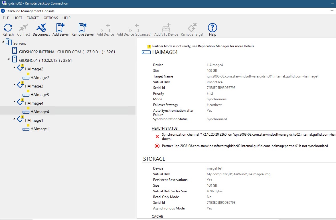

10.0.2.12 has HAImage 4.
StarWind VSAN.jpg (128.05 KiB) Viewed 30700 times
