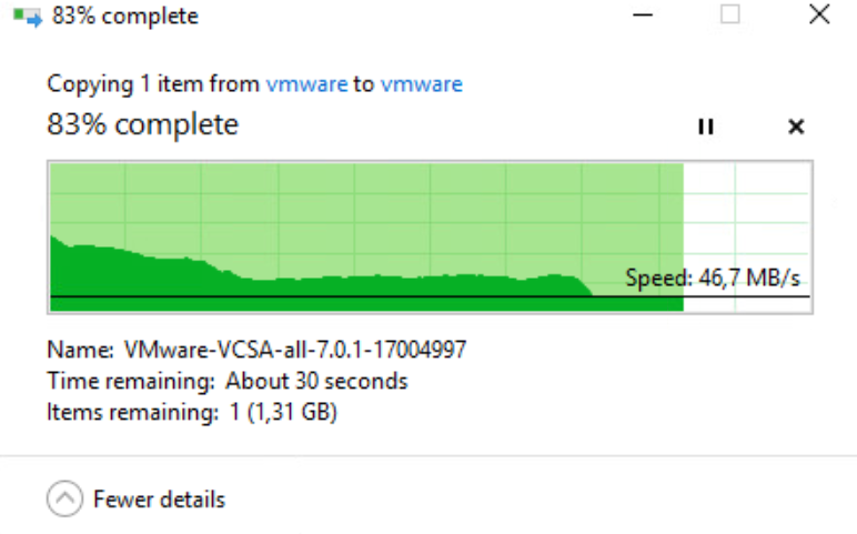

we have configured a 2-node cluster according to the manuals, but the storage performance seems to be lower than expected (when copying files, we get sometimes 250 MB/s and sometimes much lower speeds).
Here is an example, when we start copying we get 200 MB/s+ and after a while we are at 40 MB/s.

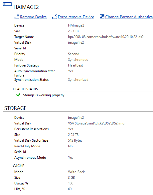

This is our storage config (each host):
HDD: 4x 2.4TB 10K SAS
Hardware RAID (1 GB BBWC)
- RAID type: RAID 10
- Disk cache policy: Disabled
- Write policy: Write-back
- Read policy: Read-ahead
- Stripe Size: 64K
The vHDDs inside VSA appliances are thick provision eager zeroed and Heartbeat/iSCSI and Sync networks are 10GbE with jumbo frames enabled.
Device settings:
Is there anything else we can do to improve storage performance?
Would changing the VSA VM performance profile make a difference?

Welcome to StarWind Forum. That's the known issue of SMB data transfer in Windows Server (see the workaround here https://docs.microsoft.com/en-us/window ... e-transfer).
May I ask about the bandwidth of the Management link (data is likely to be copied over it)?

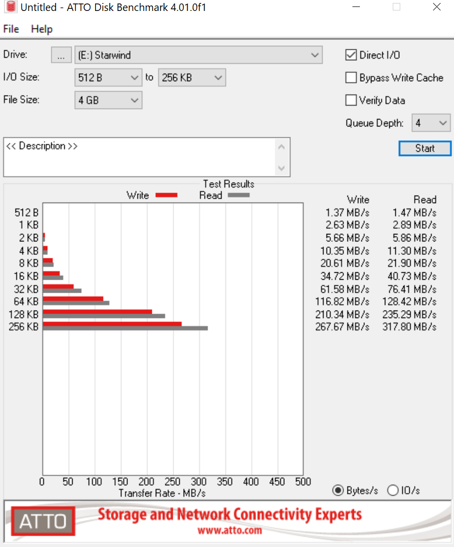

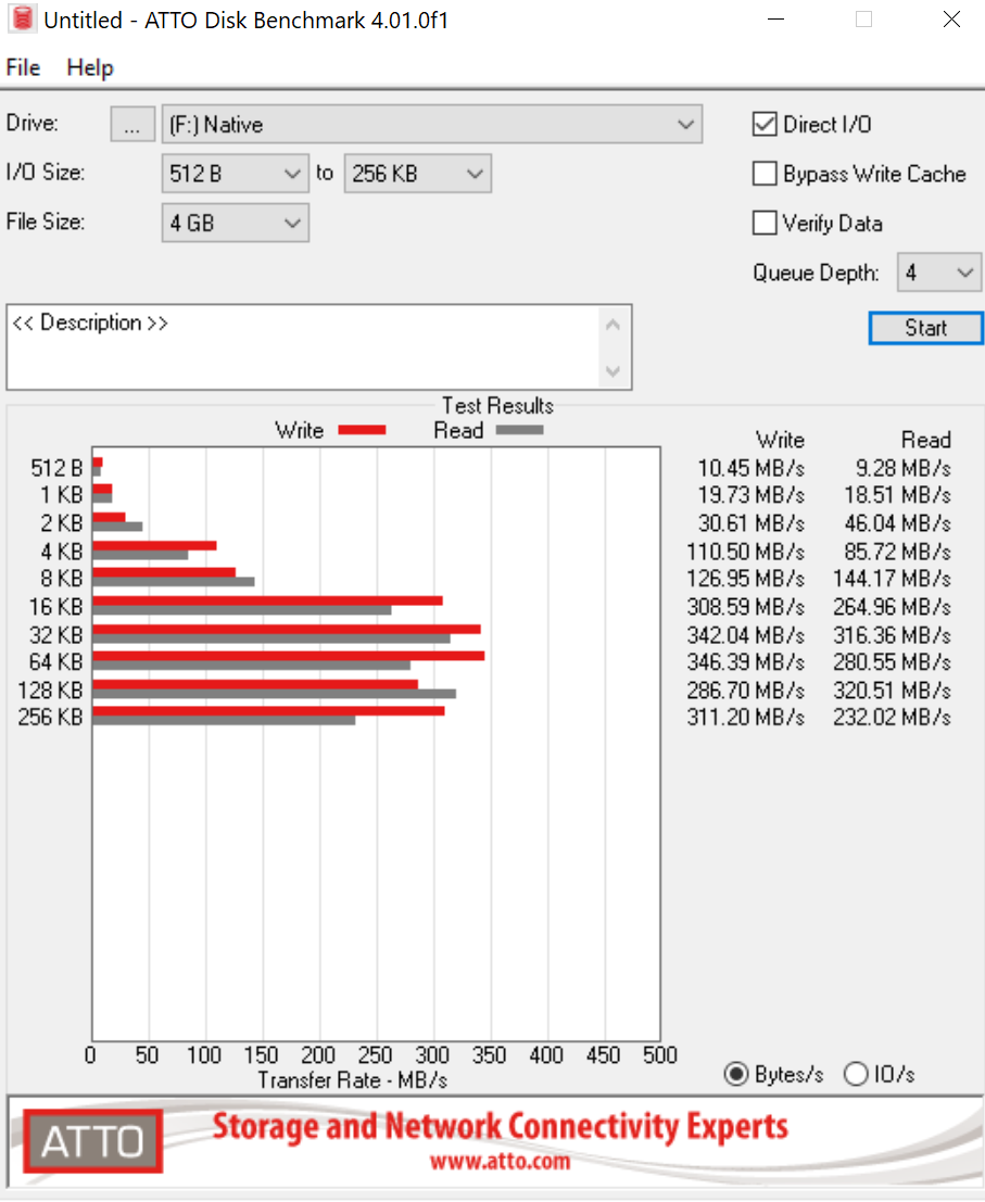

I've performed another test - I've added two 20 GB drives to a VM. The first was located on a "StarWind" datastore, the other was directly on the VMware's datastore.
Posts: 4510

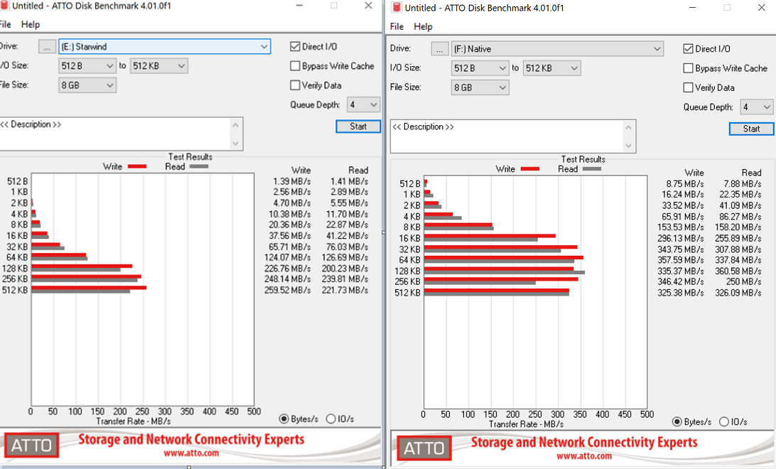

Mon Feb 01, 2021 9:12 pm
I've checked, but the management link is not being used (see the ~300 MB/s (+-50 MB/s) limit in both tests.
What I find quite interesting is the huge difference when using small I/O sizes (16 KB :o)
