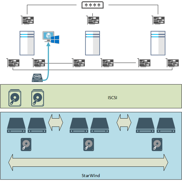

The sheet of my lab environment is below:
Which networks are missed?

On your drawing, it seems that you missed iSCSI.
The iscsi layer is under vhdx file on the picture
