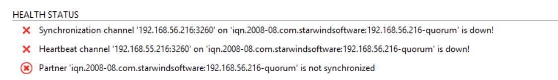

how can i check the health status using these scripts.
I am particularly interested in find status of
synchronisation channel
heartbeat channel. and
partner
as per the screenshot attached.
Screenshot 2020-09-25 at 12.53.02 PM.png (91.97 KiB) Viewed 16715 times
Fri Sep 25, 2020 7:31 am
Greetings,
This implies that both sync and heartbeat channels are down.
Can you ping these IP addresses? Normally, if you see that sign you should try disabling jumbos on your NICs, check the driver, and firmware versions. There might be a faulty NIC too. First, try pinging.

yes, the channels are down.
my query is how we can get these status using powershell ?
Fri Sep 25, 2020 8:13 am
At this point, there is no way to get that in PowerShell using the existing scripts.
You are always welcome to develop your own script though using the parts of the existing ones.

Fri Sep 25, 2020 9:09 am
No, currently, there is no such a ready script and I am not sure if there are the commands that enable checking StarWind VSAN links' health status.
Regular ping -t here should be enough I guess; if there is an interruption or delay, the alert has to be generated.
Fri Sep 25, 2020 7:19 pm
I have just realized that you can set up notifications for these events in application logs https://www.starwindsoftware.com/help/E ... dVSAN.html.
