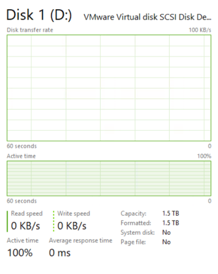

Basically when the storage is under significant load (e.g. if I start all the VMs at once or one starts performing a lot of writes/reads), the LUN completely locks up and stops responding for a period of time. The CPU is fairly idle and the RAM has room to breathe as well.
When I was running Windows Server 2019, the D: volume that holds the VSAN LUN would go to 100% active time in the Task Manager, while showing zero read and write operations occuring (the "Frozen disk" screenshot attached to my post shows this). The Event Viewer -> System Log within Windows would show stacks of errors around the disks when this happened as well (unfortunately since I've rebuilt the VM to Server 2016 I no longer have these handy).
Running Server 2016, the disk does not show 100% active time, however the read and writes do fall right down to zero. I have confirmed the D: volume is unresponsive within the OS itself, but strangely this did not affect the C: volume of the VM and it would operate completely fine in that regard, so I don't believe the problem here is the physical disks or the RAID card. The event logs do not show anything useful in Server 2016.

Frozen disk
Frozen disk
