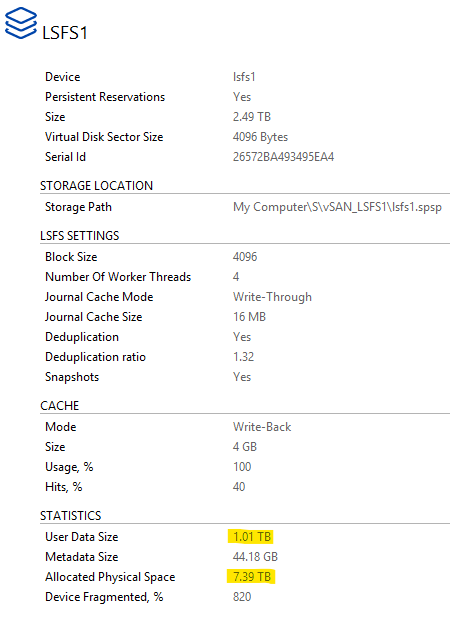

I have been using Starwind vSAN free v8.0.13182 for the last few months. I am very impressed by the speed of drive, and once I learned the correct powershell commands, administering it was fine as well.
I have used the advice here and setup a ReFS mirrored array, then a deduped LSFS device on top of that. I have adequate RAM, and I have created my LSFS device based on 200% over-provisioning.
Attached is a screenshot of the LSFS device showing just over 1TB of user data, that it is taking up 7.5TB of physical disk space. Is this expected behaviour? Is there some sort of manual garbage collection that I am meant to be running?
LSFS Device
LSFS Device
Annotation 2019-12-02 105229.png (26.96 KiB) Viewed 89408 times
How do I keep this disk usage under control?

My underlying storage is 7.48 TB in capacity, and the LSFS device is one-third of that at 2.49 TB, so I have left 200% additional capacity on the underlying storage.
The concern is that at the moment the LSFS device only contains 1.01 TB of data, yet is consuming 7.39 TB of storage; by those numbers I would have to be over-provisioned by more than 600%! From what I can see there has been none of the automatic defragmentation that is mentioned in the https://knowledgebase.starwindsoftware. ... scription/ page:

My user data has stayed pretty consistent over the last 2 months (hovering around 1 TB), but the "Allocated Physical Space" has been growing until it filled the underlying storage and the "Device Framentated, %" has stayed very high (currently at 820%).

The thing about LSFS is that it does grow over time as data operations are processed. Your device's size is not just 1TB, it's 2.49TB. And taking into account the 2x overprovisioning ratio for an LSFS device you would need at least 7.47TB of the physical storage. Your value of 7.48TB is pretty close to that, so you may want to consider recreating the device with a smaller size. Otherwise, you may want to use flat image files for the whole capacity of your storage.

The issue with too much storage consumption was preconditioned by disabled automatic defragmentation option at the time of the device creation.
If anybody happens to stumble upon that here is an instruction on how to overcome this:
1. Stop the StarWind service to enable device header editing. Unfortunately, it cannot be edited on the fly.
2. Locate the *.swdsk file in the device folder and make a backup of the file prior to any further operations. Open the original one with some text editor (Notepad++ is ideal for this purpose).
3. Find the line:
<AutoDefrag>no</AutoDefrag>
and change its value to "yes"
<AutoDefrag>yes</AutoDefrag>
4. Save the file.
5. Start the StarWind service. After the service is started, open the above header file again and check the value of that parameter (should stay "yes" if everything is done properly).
As reported by the user, storage usage went down from 10TB to 1.1TB, and fragmentation ration went down from 1100% to 26%.
