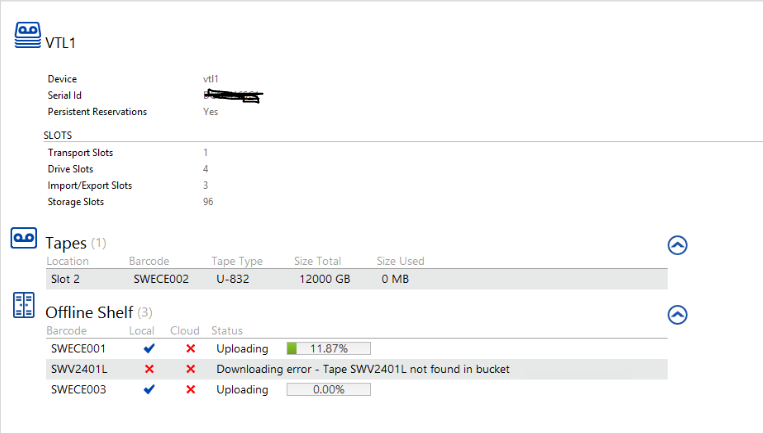

I am running the free version of VTL and using powershell for management, but I cannot find any documentation or anything on how to load a tape from the offline shelf to a slot.
When I do a listing of slots with the provided script, the offline shelf doesn't show up.
I also have a tape in the offline shelf I would like to delete, but it is the same issue, I have no visibility to the offline shelf via powershell.

This actually doesn't work for me. If I check the tapes in the library with:
	foreach($tape in $device.Tapes)
		write-host "Tape:"
		$tape
I do not get any tapes that are in the offline shelf. The question here would be how do you populate the variable for $tape? If I use a string, it doesn't come back with anything. If I list all the slottypes with:
foreach($slot in $device.Slots)
		write-host "Slot:"
		$slot
I get transport, import/export, storage, and drive. There is no "unknown" type.
Would you be able to provide a little more information?

This does not work for me. I don't know if I am missing something. Here is my output:
PS C:\Program Files\StarWind Software\StarWind\StarWindX\Samples\powershell> foreach($tape in $device.Tapes)
      if($tape.SlotType -eq "unknown"){
            write-host "Tape:"
          $tape
As you can see from this output, I have one tape and it is the online one.
PS C:\Program Files\StarWind Software\StarWind\StarWindX\Samples\powershell> $device.tapes
Barcode   : SWECE002
SlotType  : Storage
TapeType  : U-832
UsedSpace : 0
Also, I am attaching the output of $device.slots below:

Lastly, so you can see the tapes are available in the offline shelf, I have attached a screenshot of the management console.
Maybe the issue is because they are still in the uploading phase? If that is the case, what if I wanted to stop the upload and delete them anyways?
Also, how would I remove that one that it couldn't find, SWV2401L?
