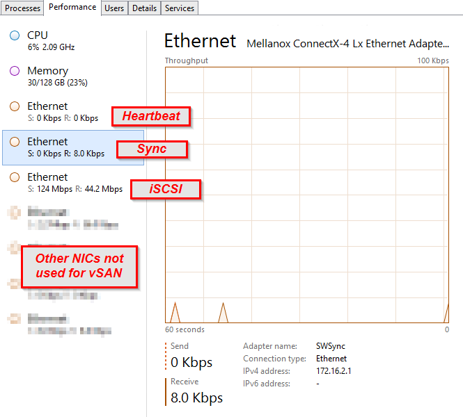

Question 1: With all VMs running on one node and VMs running from a CSV (on iSCSI from vSAN) that this node is the 'owner', in Task Manager I see alot of traffic on the iSCSI interface going to the other node. Why?
Question 2: When the node is accessing it's local storage should I see traffic on any of the NICs? I thought it would use the virtual loopback device? (which I cannot see except with Wireshark)
Question 3: I see very little traffic on the Sync interface/NIC. Is this normal? I would expect the traffic I see on the iSCSI NIC to actually be on the Sync NIC. I checked the Replication manager has the Sync NIC listed as the Sync Interface :wink:

1. All data in HA devices must be the same. Thus, if your virtual machine is located on node 1, all data is immediately replicated to node 2. The synchronization process between nodes uses a synchronization channel, so it is the reason why you see traffic on the synchronization channel. :arrow: I only see little ~8KB spikes on the Sync Channel, this is when there are 2 TFS build servers running a build - I would expect some data to be written to itself via the loopback and to the other node on the Sync channel, but I do not see that.

I had seen and read the best practices before and I just checked again - I see no problems. Maybe I should simplify/reword my question:
Why do I see traffic on the iSCSI channel when all the required data is stored locally? The other node has no VMs that access data on the vSAN volumes.
Screenshot of vSAN traffic
