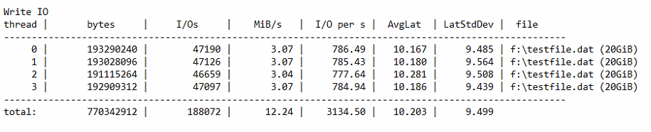

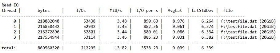

I'm running some diskspd tests on our Starwind HA Cluster. I have 12 2.5 inch hard drives (10K - 600G) configured in Raid 10. It's a clustered Hyper-V environment. Testing from inside VM yields the following results for random 4k reads and writes.
I think these results are par for spindle drives but I'm not a guru. What does everyone else think, are these about right?
Command: diskspd -t4 -o8 -r -b4k -w100 -h -L -c20G
Result:
Command: diskspd -t4 -o8 -r -b4k -w0 -h -L -c20G
Result:
