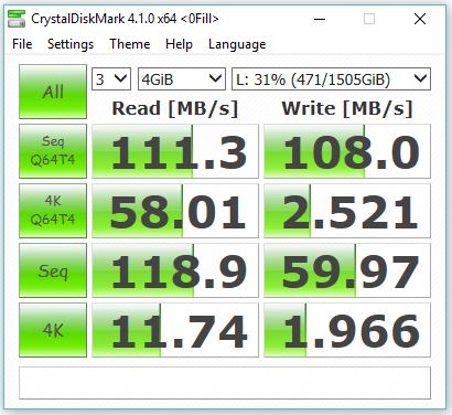

I've come back to starwind after some time with freenas, But this time the write performance is way worse then I remember. See the attached pic.

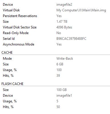

This is with Write-Back turned on and 6GB of RAM.
It could be because i'm using ReFS this time, that has a cluster size of 64KB where as the underlying storage is 4KB.

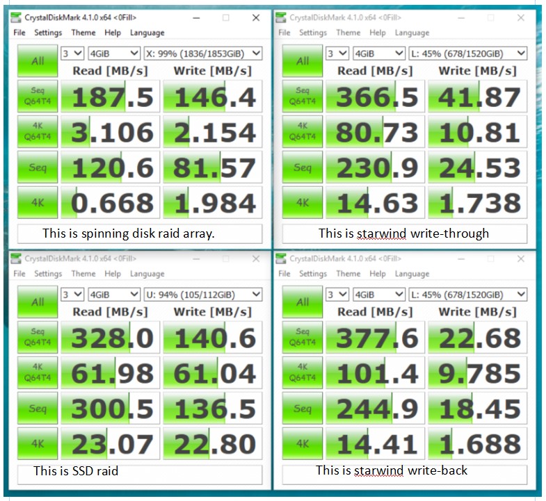

Update, changed it all over to NTFS and now I get this. Now it's like the RAM cache isn't used at all? except for ramdom reads.

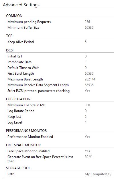

Here are some pics of my settings.

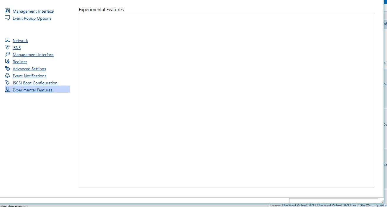

I though about turning L@ write cache, but I don't have the option to enable any experimental features.

Tue Apr 17, 2018 12:02 pm
Can you share more information on the underlying storage? The main things we need to know whether the settings you have comply with the recommended ones found at https://knowledgebase.starwindsoftware. ... ssd-disks/
Additionally, how is your iSCSI initiator configured? We would need as much information as possible.
Moreover, our Support Team will contact your directly.
