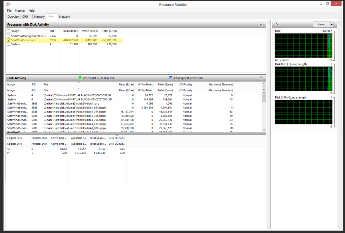

While I haven't experienced complete failure of the storage system as indicated by Blowfish-IT, I have noticed that both nodes in my HA setup running under build 11818 for the last month continuously consume around 200-500MB/s heavily skewed to reading LSFS device files as you can see from the screenshot below from one of the nodes. This reading activity occurs even when all workloads (iScsi) are disconnected from the cluster (I think another poster recently indicated similar activity but I can't find the post now). This was a clean installation (archive data, full uninstall of 11456, cleanup, install 11818) with all new LSFS devices and data migrated as per the installation notes. I did not have this behavior under 11456 and the only thing different than the VSAN build is I enabled deduplication (never used it before). After restarting both nodes everything functions fine for a while but eventually after several hours, the continuous reads come back and consume more and more disk IO. The only two Starwind errors since the last restart a week ago that I can find in the windows application log are: GetQueuedCompletionStatus returned Error 6, File = '0x000000000000ADCC', and GetQueuedCompletionStatus returned Error 6, File = '0x000000000000AA88'. This cluster is running on W2k12R2 with all latest updates from MS.
I should point out that from a workload standpoint everything on the LSFS devices appears to be ok (nothing corrupt) except for sluggish performance, although a few weeks ago node 'B' ran out of space on the disk for the VSAN device files and that caused VSAN on both nodes to grind to a halt which resulted in corruption on some of the 'surviving' node LSFS devices (after restart) which I had to restore from backups (Host OSs on both nodes were still operational and no power outage was involved). All vsan devices are running in WT L1 cache (no L2/flash cache) mode and the array controllers hosting the LSFS files have 1GB flash/super-capacitor-backed WB cache). I've never seen that happen before.

Kevin, the described behavior looks like LSFS volume defragmentation. Although LSFS itself is designed to turn random writes into sequential ones, it still requires some defragmentation when the outdated journal files are processed and no longer required by the system.
