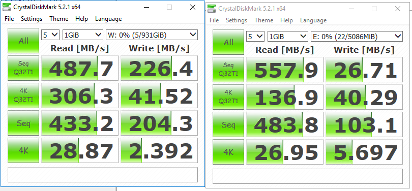

Benchmarks, RAID drive on left, starwind drive on right

There is definitely something weird going on. I created a 5gb Virtual drive on a locally attached SSD, and then mapped it via iscsi loopback, and didn't add in the secondary connection to the other server, to remove the network and the RAID controllers as a source of issues, and I get even worse results:

I ran the Storage test provided by starwind and it backs up what I saw with CrystalDiskmark
First disk is iSCSI loopback, second disk is actual RAID drive

So I found some issues with my infiniband, and after some more testing, I've confirmed that the bottleneck is the loopback adapter, I can map a drive via iSCSI across the infiniband and I get 4x the write speed to an SSD on the other server. I also noticed that evertime I reboot, the "iscsidiscoverylistinterfaces" line is always changed back to 0.
