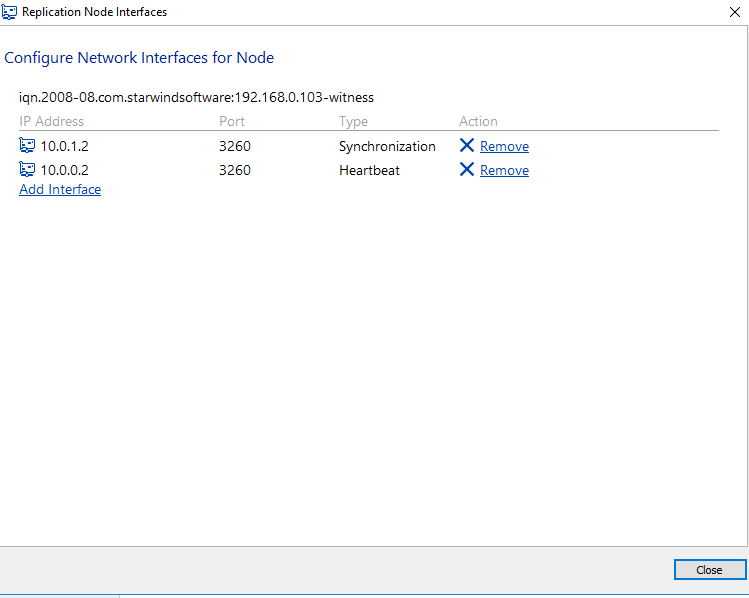

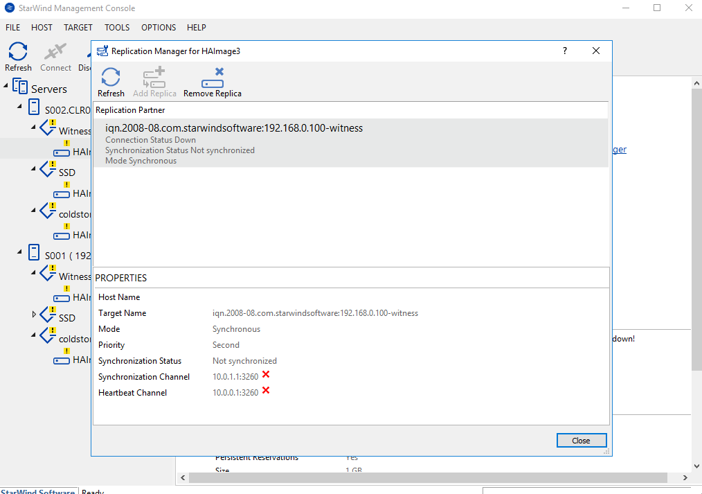

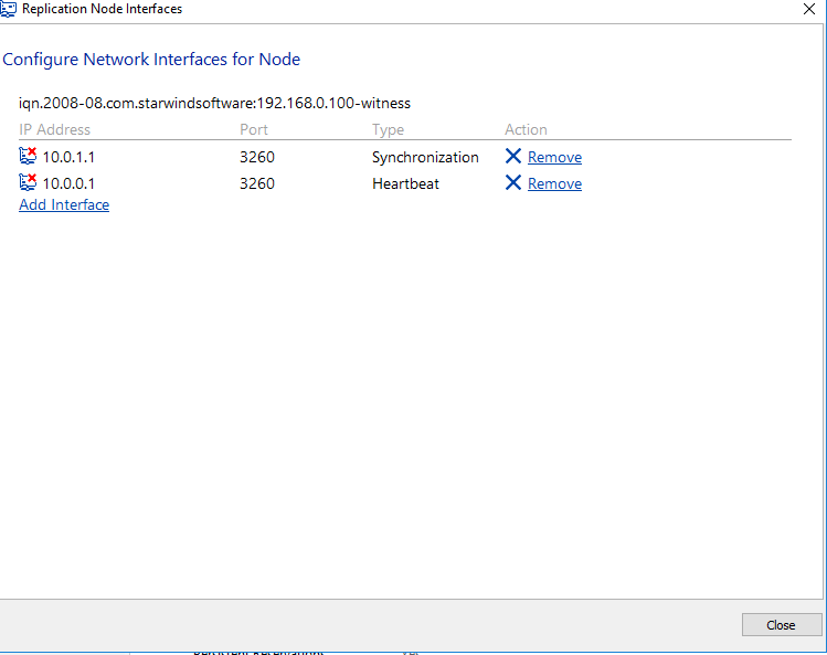

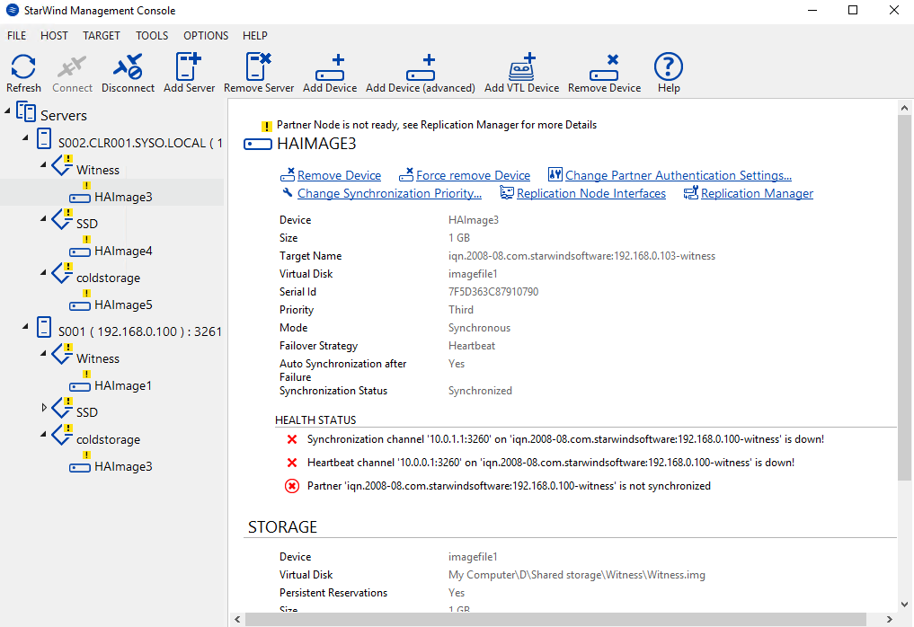

Could you show me some screenshots of how the same device looks on both servers in terms of Replication Node Interfaces?
jortie
Posts: 12
Joined: Wed Sep 27, 2017 12:34 am
Thu Oct 12, 2017 11:43 am
Here we go
jortie
Posts: 12
And the last one

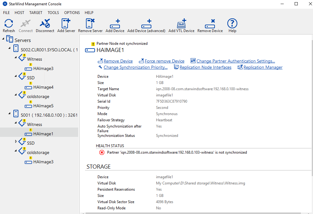

Thu Oct 12, 2017 12:04 pm
Thank you.

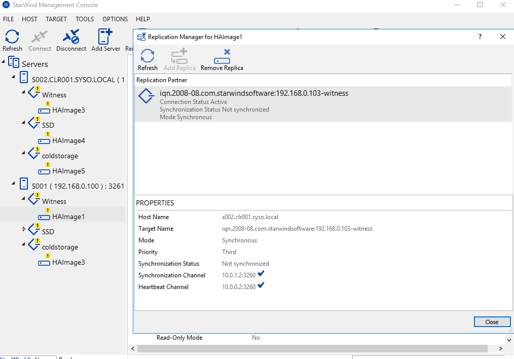

In fact, I requested Replication Node Interfaces, but not Replication Manager. Could you post that for at least HAimage1 from both servers?
jortie
Posts: 12
Thu Oct 12, 2017 3:04 pm
Sorry about that.
node1
node1
node2
node2

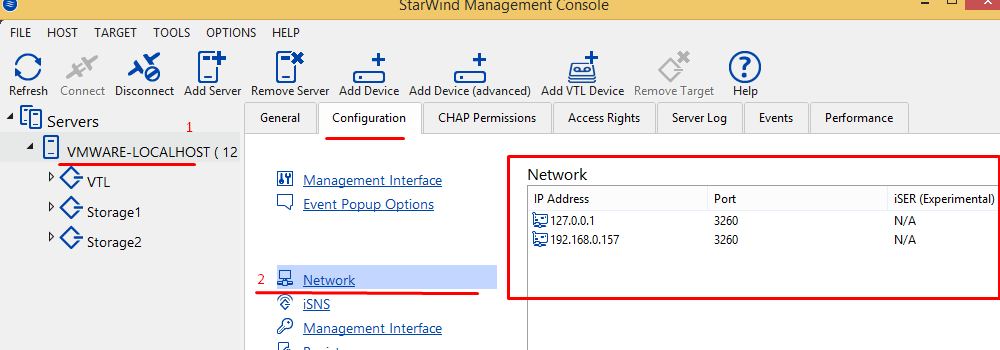

Ivan (staff)
Posts: 172
Thu Oct 12, 2017 6:44 pm
Hello jortie,

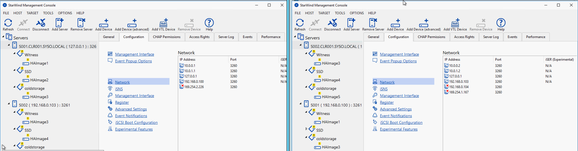

Could you please share the screenshot from "Network" tab on each StarWind node like on the picture below?
Thank you.
jortie
Posts: 12
Thu Oct 12, 2017 11:21 pm
Here you go!

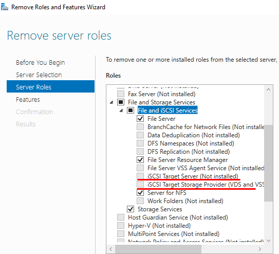

Fri Oct 13, 2017 11:53 am
Hello jortie,
Thank you for screenshots.
Could you please check "Windows features and Roles" and remove the features like on the screenshot below (if exist) and reboot the server.
Thank you.
jortie
Posts: 12
Fri Oct 13, 2017 4:31 pm
They are not installed on both nodes.
