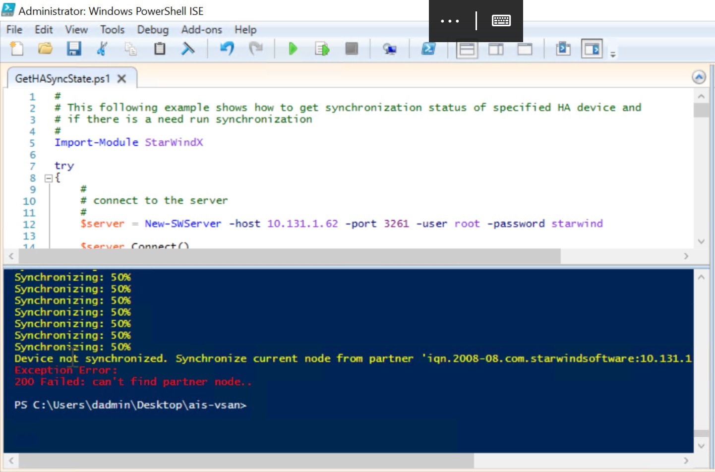

Everything worked fine, but with long disconnection of the second node, the synchronization ends, or does not start at all.
An attempt is made to synchronize an error "Device not synchronized. Synchronize current node from partner 'iqn.2008-08.com.starwindsoftware:10.131.1.61-ais-iscsi-fast'
Exception Error:
200 Failed: can't find partner node."

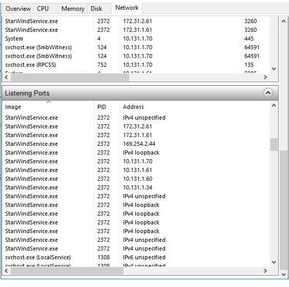

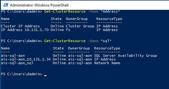

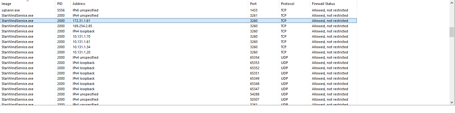

When trying to solve the problem, it was found that the resources of the cluster (ip address 10.131.1.34, 10.131.1.70) listen for the ports of Starwind 3260.
Previously, while the Management Console was available, we could see in it these interfaces (ip address 10.131.1.34, 10.131.1.70), which Starwind automatically adds. And we could remove them from there and the synchronization passed normally. How should we be in the case of the Free version?

I also want to note that Starwind listens for interfaces not specified in the configuration.

This is error: Exception Error: 200 Failed: can't find partner node..

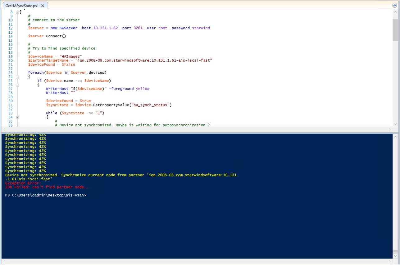

Dear Starwind team!
Please help in my problem. We can not work normally.

again..

madmongoose wrote: Previously, while the Management Console was available, we could see in it these interfaces (ip address 10.131.1.34, 10.131.1.70), which Starwind automatically adds. And we could remove them from there and the synchronization passed normally. How should we be in the case of the Free version?
An update for the community:
there is a method in StarWindX library called SetServerParameter allowing to remove interfaces.
Example:
import-module StarWindX
$ s = New-SWServer 127.0.0.1 3261 root starwind
$ s.Connect ()
#Set list of disabled network interfaces:
$ s.SetServerParameter ("nolisten", "192.168.61.1:3260,192.168.60.1:3260")
