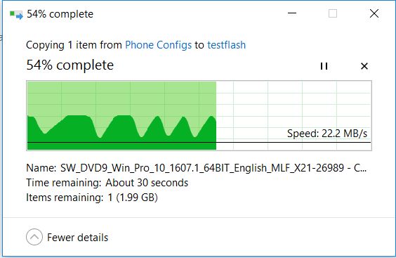

I am trying to track down a performance issue I am having with a newly configured enviroment.

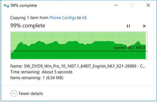

As you can see from the Image. File transfers over SMB slow down to nearly nothing at a regular interval

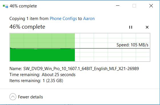

I have an existing File server which is just a Windows server with a RAID on the same network and it is steady and does not have the same issues. So I dont think it is a network issue.
File Transfer Legacy.JPG (38.17 KiB) Viewed 18442 times

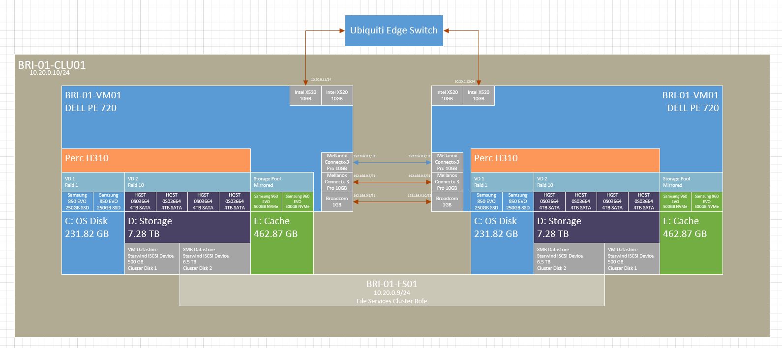

I am using 2x Poweredge 720s
64GM Ram Each and both have dual 8 core
Perc H310 Mini RAID Controller
4x HGST 0S03664 4TB in Raid 10
Intel X520 10GB Network for the front end connections and the hyper-v hosts
Mellanox Connectx-3 Pro 10GB for the Sync and iSCSI Connections
Broadcom 1GB For the Heartbeat
For testing purposes I created a Device on my NVMe disks and had the same issue.
When I copy files to the drive that hosts the Starwind Device IE (\\servername\e$) I do not see the same issue.

It seems to only be when I connect to the cluster share that lives on the starwind replicated device I get the issues \\cluster\share
I also am not getting very good performance when I go to any of the VMs that live on the cluster \\virtualguest\c$
